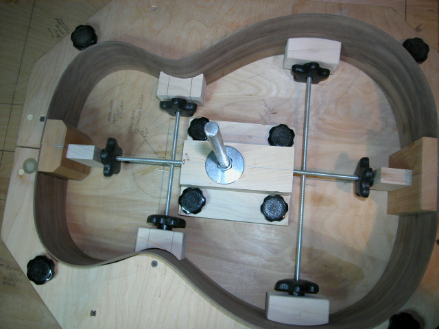

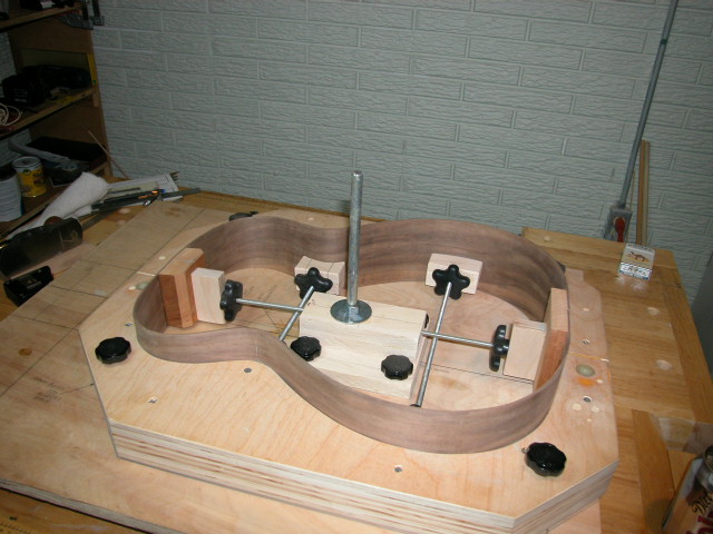

Even though I am new, I am somewhat proud of the workboard/mold/radiusing set up I built.The workboard is 3/4 birch ply with a centerline and the outline of the guitar body incised. The mold fastens to the board with inserts and the knobbed threaded rods. The center block and axle for the dishes fastens to the board the same way.There is a swappable steel insert for the soundhole cutter/rosette rout set on the centerline.Maybe someone, most likely another rookie, can get some use from it

Mike, Why do you have the rigid center post? I like the freedom to move the radius dish around loose using more of the surface area of the sand paper, and this does not affect the accuracy of the radius dish surfacing.

Hi Barry, I do it like you for the same reasons. One thing I don't like about it however is the tendency my fingers have to hit the rims or mold and skin my knuckles. That's one of the reasons I want to build one of those motorized affairs. I guess when I put my fingers in the wrong place on that set up I will REALLY feel it, huh?

The center post makes quicker work of it, I use a similar deal. I put a crank handle on the dish and just spin it round and round while the weight of the dish does the work.

The center post just makes it easy. The downside is, of course, that only one area of the sandpaper is used.On the other hand, I got my sanding paper from John H.-very low price. If I get to where I am doing enough guitars that it makes an economic difference-well, I'd be so darn happy it would be a small price to pay.Another side note. The workboard is also marked for the Martin slope dread shape using the same centerline- the soundhole for it is centered on the same steel insert for the rosette.The work board has short legs at each corner and maple 3/4 by 2" stiffeners on the underside to keep it flat. I clamp the whole mess to my bench in use.
