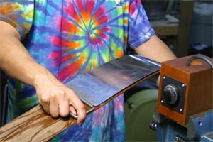

Alain, are you using a backing strap? What this is if you don't know is a piece of metal over the side/binding to support the outside of the bend when bending. This realy helps to support the bend all the way through.
This pic is off the LMI website.

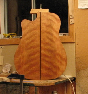

   Here's a pic of the back (Cherry wood from Colonial). I don't think the bend is too sharp or exagerated.

Your bend is not overly tight, but it is tight enough. If you pipe is so hot that water instantly vaporizes than you have got it to hot. Usually I like to see the water drops bounce a bit and then evaporate. Cool the pipe, thin the binding a bit and take it slow. You should be all set.
