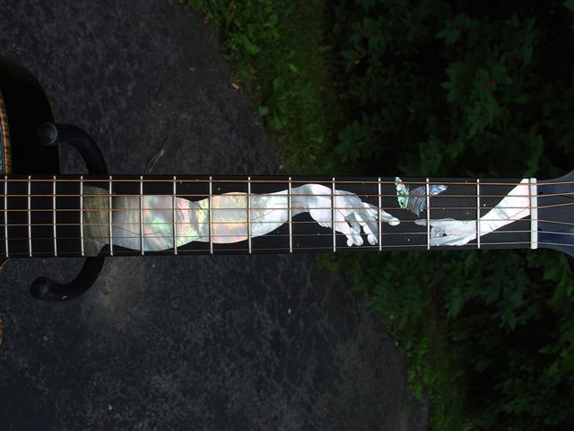

Here's an example of an inlay done a few years back on a radiused, pre-slotted fretboard using separate pieces to create a single large image.
I recall not routing through the slots on this one, but modifying the drawing to cut just shy of the slots. This was done by duplicating the fret positions exactly over the drawing and using a dull pencil to widen the gap needed on either side of the slot.
Cut your piece, sand to the line,check and re-check!!!
I found having the fret reference lines on each pattern piece was much quicker and safer then sanding back afterwards.
Paul Bordeaux
http://www.bordeauxinlay.com

I forgot to mention re-slotting if you get glue in the slots; Stew-mac sells a .024 kerf saw with a depth of cut adjustment on the frame. I use it all the time so a builder doesn't get a surprise when it comes time for the fret job!
