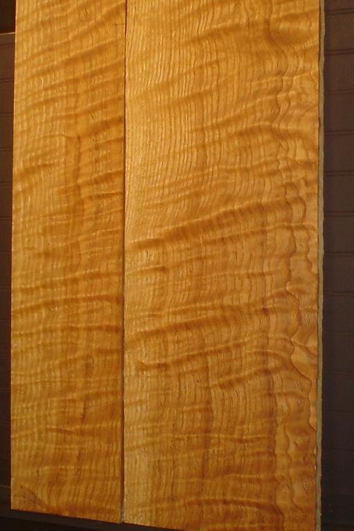

I have played a few imports that I thought sounded very good. Martin built a few years ago. I have one body together waiting for a neck. I think it was Al that said oak made a good sounding guitar. It's a perception thing with potential buyers because oak is such a common wood and that's a shame. If your building for yourself I would go for it. Here's a picture of some QS Curly White Oak I'll be cutting today.
Bobc38773.438900463
PostPosted: Sat Feb 25, 2006 3:09 am
That's beautiful, Bob. I might buy a set of that and try one myself. PM me with a price for the pick of the litter.

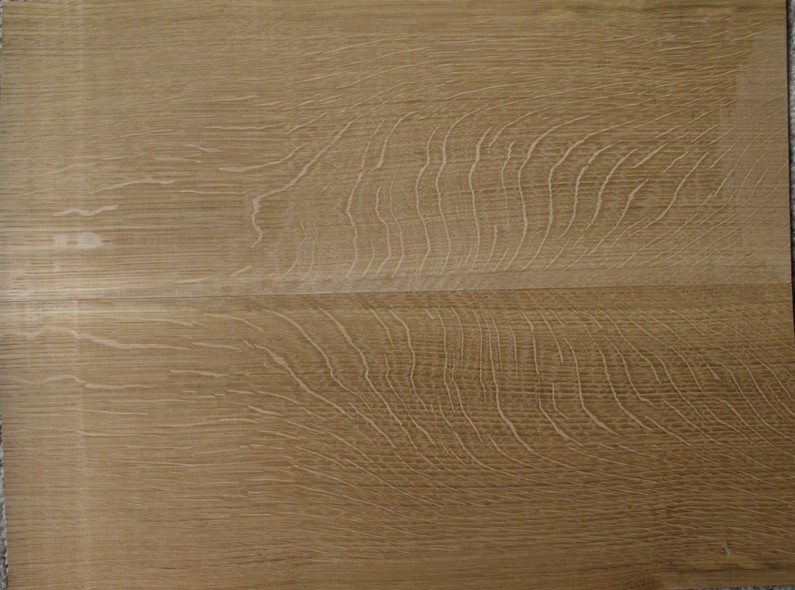

I bought some quartered oak recently. I think it really is unique and it appears that there is now some acceptance of alternative woods. Have a look.
I can't wait to give it a try and see how it sounds. That will probably be the only way I'll get to hear an oak guitar.
