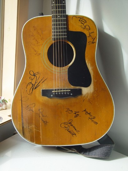

I was contacted about possible doing the repair work on this guys Guild D50-NT(#179203). Apparently he slipped on some ice and put his elbow through the top, that is all I know. I’m not sure how this would have happened if the guitar was in its case, but maybe it was a gig bag or something. Anyway the damage has been done. The guy lives several hours away and so I don’t have anything to go on other than some pictures he sent me. He lives in the middle of nowhere and to my knowledge is not near any luthiers who could do the work. Right now he is waiting to hear back from me as far as if the repair is worth it and a cost estimate. He has had this guitar for about thirty years and seems vary attached to it. I thought before I get back to him I would run this by some of you repair guys.
As best I can tell the repair would involve gluing the top cracks (hot hide glue?), fixing the damaged braces, and then reinforcing that part of the top. Since the guitar is not here I can’t tell what sort of internal damage this may have caused. Please give me any thought or advice you might have on this job. I do repair work on the side but most of it is fairly minor. Once in a while I get a bigger job like this and the extra advice would be appreciated. Also if there is anyone who knows a lot about Guilds and can give me some more details on the guitar that would be helpful (or point me in the direction where I can find the info myself).

Wow Josh, that is not a fun one! I have done a few sentimental value jobs with shattered tops that actually came out great. You will need some brace jacks and something to push up the top to align the fragments, sometimes it is amazing how these things pop into place with a little pressure. It will be hard to see how easy it is without looking inside.

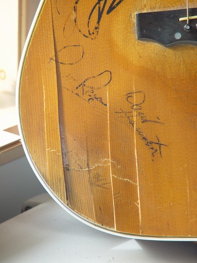

This is a risky repair if your not experenced in this kind of repairs. I would guess ther is at least lose braces if not broken braces involved. I see major cross grain breakage. the grain line breakage is not that hard to repair but the cross grain is tougher and will have long term affect on the tops stability. This would be a easy near $750-$1k repair in most shops not counting finish.MichaelP38797.5905787037

Evan is right...it's going to be hard to know without seeing inside. If the X is broken, it could be in need of having the top pulled, repaired and reinforced and re-braced where needed. It's awfully difficult to do that with the top on, but I'm guessing Frank Ford could give some advice too...

I had a similar repair to do on Guild '62 M-20, most braces were cracked
under the top, so was the bridgeplate (probably not the case with this D50
although it looks somebody screwed the bridge onto the top & bridgeplate
and then masked the screw heads with pearl dots -a la Gibson-, not a good
sign for what might hide inside…). Anyway I had to remove the M-20 top,
glue the cracks, redo the whole bracing, bridgeplate etc. and glue the top
again. A lot of work, Michael's price estimate is good if there is major
internal damage.
You might not have to remove the top, but possibly the binding to repair the
lining as well. It's entirely possible the x-brace is intact and just needs to be
reglued along with the top cracks.
You should give him a wide estimate and explain that you need to see the
guitar to be more specific, or request possible inside pics.

There is no good and reasonable quote you could give the client without having the guitar in shop. I can tell you that if no structrual damage to bracing exists and they are all still glued tight. I would ask in the neiborhood of $300-$500 to repair the top and more if there is brace damage. I would charge probably $500 to replace the top and bridge plus a finish charge.
