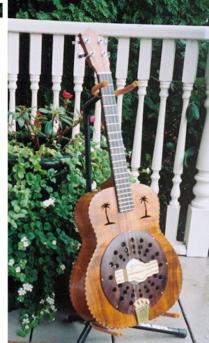

I dug up another option...turned rosewood a la Michael Dunn.
What clean work!

Coverplates are too thick to spin (at least not without
machine help) and are typically stamped with a
multi-ton press. Expensive dies are also needed.
It's a tough situation, Nationals are too pricey (and
the sieve-hole pattern is 'off', that drives me nuts)
and the off-shore ones aren't as nice as I would like
with visible spot welds on the handguard etc.
In the Dobro world things are a little better with some
very nice covers available. These will work with both
single and tri-cone National set-ups.
Besides wood, fiberglass is a viable option if you
don't mind a painted finish.

Yeow! I like everything about that instrument, koa, rope binding, palm tree soundholes and all.
I've posted a couple of images showing one of the coverplate patterns I came up with. It's very similar to the rosewood coverplate. View 1 shows the basic design. View 2 shows the holes laid out for drilling. When it comes to the actual fabrication, I'll print the layout at full size, them glue it to the sheet of brass or copper. The same design could also be rendered in cold-rolled steel.
D..
D..
PostPosted: Thu Mar 23, 2006 4:15 pm
Joined: Fri Dec 16, 2005 1:47 am
Posts: 504
Looks great Dennis!
