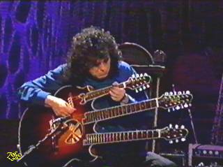

i m talking a full on acoustic thing.
kindda like this:
should be challenging and interesting
Udi.
PostPosted: Thu Mar 23, 2006 4:39 am
Posts: 575
Ahh, that is cool. A flat-top, with a pinned bridge. Is that one built by Andy Manson? It's very good.
I prefer to use floating bridges and a tailpiece. I can see how that may not work well for a triple-neck kind of instrument, but that's what I am going to use.

yep, thats the one built by mason indeed.
its pretty cool i think, even though not the most practical musical instrument...and i guess theres a reason why Jimmy Page only used the mando, and none of the other two necks.
but figured itll be cool having this thing hanging on the wall in my room.
