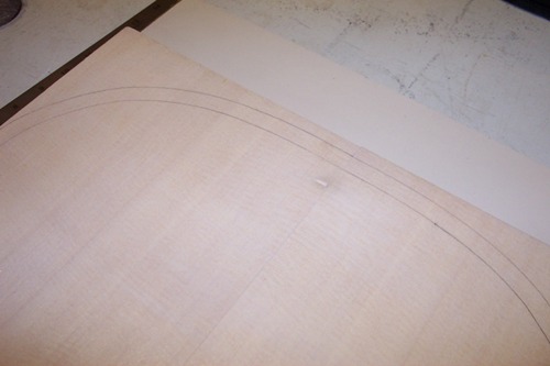

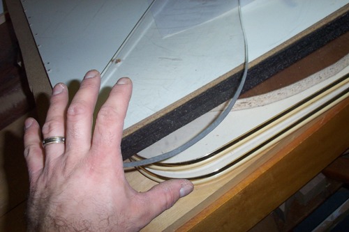

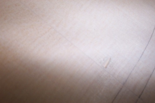

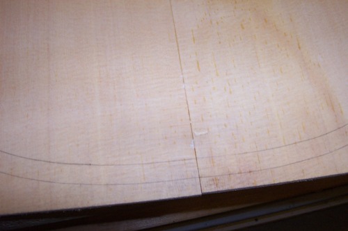

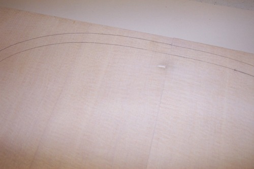

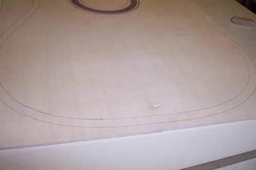

Hi folks, i guess s**t happens to most of us once in a while, tonight i encountered a deception, i dropped my template on my top that i had just sanded to 0.16", i thought i was gonna be sick and then i thought Bear, no, Serge, don't worry, it's all part of the learning CURVE, the folks at the OLF have probably all went through this, take pics, show them and you'll have abunch of uncles to your rescue!
When i told my wife what had happened, she thought of encouraging me right away and helped me find solutions and came up with inlaying this mistake, sounded good to me but i thought i'd let you pros and bros advise me on this one, the dent occured at the lower bout of the top, here are some pics to better explain this!TIA
And the guilty hand with the accomplice

A)flip it over and use the other side?
B) .160" is AWEFULLY thick. WHen you get down to .120 or so will it have disappeared?

Terry is right at .160 is way thick enough to sand it out probably. I can't see dent enough to tell, but damp rag and iron and steam it out might be option as well turn it over. Lot of way to go

I assume it is on the top surface of the plate? The one you already have the rosette in? If the rosette is not there than taking it down to .012 or so ought to do it.
If you can't do that then heat up a cloths iron to hot, wet a paper towel and lay it on the spot and put the hot iron on it. it should raise it out. A little sanding and scraping should take care of it from there. But I could be missing something.....

    I think you will be fine. First I would steam the dent up then sand to final thickness. A top can finish out .100
    Take a hot iron and a wet paper towel. You will be surprised at how much of the dent will dissapear . Lay the paper towel on the dent and iron it. Once the steam penetrates the wood cells it will swell them up and the dent will all be gone when you sand,

Thanks guys, i'll probably try to steam the dent since it happened on the top surface of the plate with the rosette(thanks Joe), i even thought od collecting saw dust from that same top, when i'll be cutting the outer perimeter, mixing it's dust with some kind of glue that would help blend it in.
The idea of sanding it down to .120 sounds good also, since it happened at the end of the lower bout, do you think it would be a good idea to thin the outer edges only?
PostPosted: Tue Apr 04, 2006 5:47 pm
Serge, don't even think about glue and sawdust on a soft wood, you'll never ever hide it that way, it will only make it stand out more.
As Stan, Joe and John have already mentioned, steam it out. Do you know how to do this?
Take the tip of a rag, roll it a little bit than dip it in some water, now take your wifes clothes iron (you decide if you should tell her or not ) and using just the tip, touch it to the rag, don't leave it there for long. Check your progress and remember to moisten (not soaking here) the rag from time to time, if the top is just dented and there are no grains cut from the drop, it should all steam out. Work it till you can't get it to come up any more, than sand the top down to the point where you don't see the dent anymore as long as it isn't less than 0.12". You should be fine here. Now if you can getaway with only sanding till the top is say 0.13 or 0.14" and the dent is gone, don't go any more on the show face, flip it over and sand from the inside (this way you won't be tempting fate and accidentally sand through that nice rosette of yours, it happens)

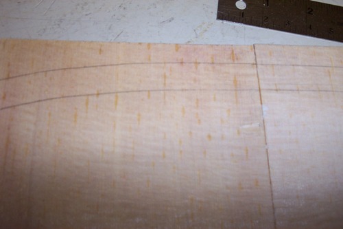

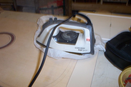

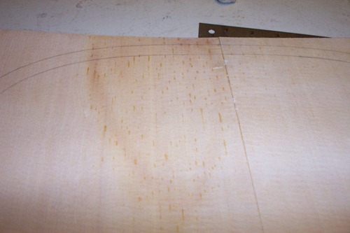

Thanks for all the suggestions of help guys, i did steam it tonight and the wood fibers raised up slightly and i'm really hopeful to be able to sand it all down ok, but another problem occured, the HHG glue joint was weakened because of the steam and heat, the dent having occured near the center line .
So my new $64 000 question is: is it possible to just wick a tiny bit of HHG in the little crack near the dent that resulted because of the steam? Not all the glue is gone, just the superficial line.

PostPosted: Wed Apr 05, 2006 4:22 pm
Ouch. Serge, you should have read my first post more clearly there. You just want to use the tip of the iron, not the entire iron like you show here
This is what you want
Take a look at Frank Fords steam out tutorial, I should have sent you here first, sorry.
As you read the tutorial, you will notice that Frank appied that little wet rag about (in his words) 100 times, rewetting and just touching the iron for a second or two, than checking the dent. So, 1/2 hour is what it took him to pull that dent up.
About the now large gap you have, you will have to get a very thin blade in there to try and clean up the glue and re-join that area with HHG and tape should work to pull it back together, maybe try heating the area up and just try and work the glue into the seam as much as possible and than close it up with the tape.
Rod True38813.0632986111
PostPosted: Wed Apr 05, 2006 5:24 pm
Posts: 338
Serge, is it the lighting or is that seam opened up quite a bit.. I could not see much of the center joint in the before photos, but in the after shots it looks bad. Does it close if you apply pressure. if so you may be able to wick in some thinned hhg and clamp it. But you really need to be able to clamp it shut. HHG isn't for gap fillin.

Mike, the glue joint is still holding, it's only the superficial bond that melted so i think that a bit of fill up and tape should do it, if it works the way i think it will, i should be able to sand it all down during the week end, i'll let ya all know how it goes.
