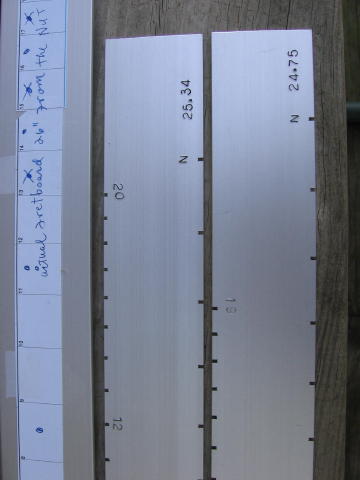

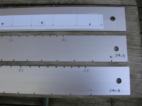

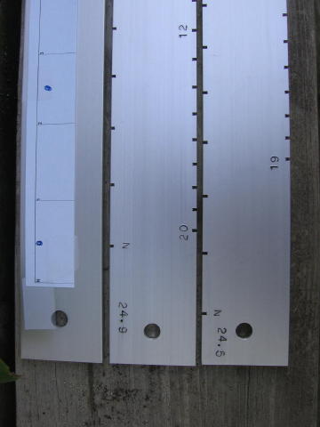

Well, what can I say except wow. Todd sent me these two "extra" fretting templates he made. I'd like to say thank you in a BIG way. Okay, uneducated luthier would like to know, whose scales do these replicate anyway?
Here are the measurements in inches:
1. 24.5
2. 24.75
3. 25.34
4. 24.9

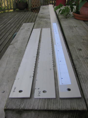

Todd sent the two on the left he made. On the right is a six foot "blank" to make three more, one for a 34 inch bass scale I'm building.
N stands for Nut.
You can see here the Wfret.exe printout awaiting scribing and notching.
More of the same.
THANKS TODD STOCK, an engineer's engineer, and he fly's choppers folks. I just fly puddle-jumpers.
