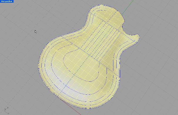

I use Rhino for a lot of my modeling along with Onecnc although I have a copy of VM. I can help with the carved top modeling; there are several methods however I've had the best results using a patch surface over a set of guide curves created by offsets from the body perimeter. Here's a sample singlecut top, the dish is only 1/32" the rendering makes it seem like more.

I've never tried using guide curves and patch surfaces. I've tried lofts, curve networks, rail sweeps, but each of them had their own particular problems. In the end the best solution I've found thus far is to do it in two parts but if I can just use straight curves that would be golden.

Here's a picture of that top with the contours. With a patch surface the geometry is there to help guide the surface so curve continuity isn't critical. The offsets are at different Z heights to create the proper dish and arch. There is more geometry for the bridge, pup and neck joint planes. Because it is stretching a surface over the guide curves it isn't going to follow them as exactly as it would a wireframe so some tweaking and trimming to the body perimeter may be needed.
