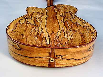

PostPosted: Fri May 05, 2006 2:02 am
Here is one of the finest examples ive ever seen.
Paul McGill
