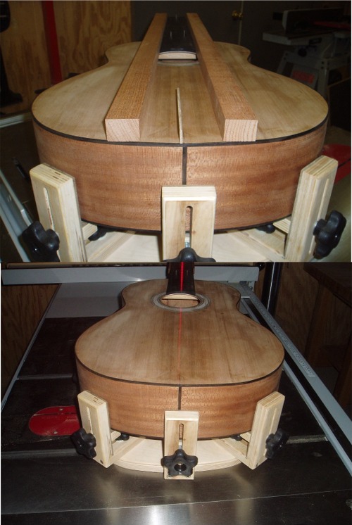

I picked this laser up at home depot for six bucks. It's helped me quite a bit.

[QUOTE=RCoates] I picked this laser up at home depot for six bucks. It's helped me quite a bit.[/QUOTE]
I like that...Star Wars Revisited!
~ Lasers in Lutherie ~

[QUOTE=RichB] [QUOTE=RCoates] I picked this laser up at home depot
~ Lasers in Lutherie ~    [/QUOTE]
What Ronn neglected to mention was the effort that went into to gluing
the top back together after he'd lasered it in half!

Good idea. I have one of those for hanging shelves, I'll give it a try to see exactly how far off I am.

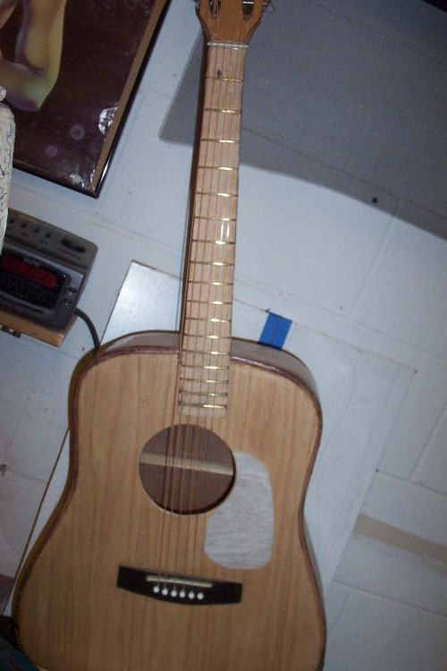

Marc, your fingerboard alignment is perfect compared to mine, check on this picture for the big E string on my first build, the neck is so off centered that i call my guitar 10 to 6!

Wat Woow MichaelP38849.6750578704

Serge, Thanks! I don't know what to say except that picture makes me feel okay about my first guitar.
PostPosted: Fri May 12, 2006 7:37 am
That was the goal! Mission accomplished!
