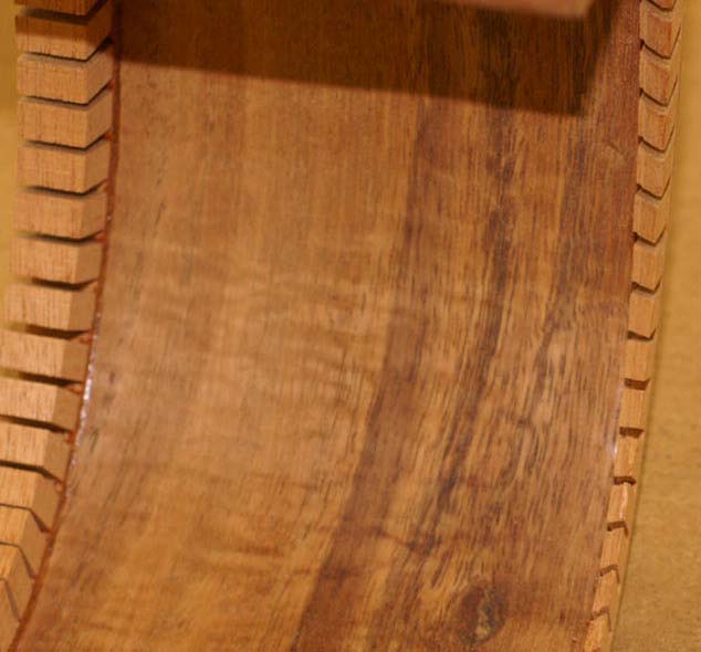

....while sanding with my radius dish and didn't check my progress often enough. Too busy listening to a Doug MacLeod cd Sanded it down to about 1/8" in a couple of places.
Anyhow, I'd sure appreciate some advice on how best to remove the lining without screwing up more. This is a pretty piece of Koa.

you could try your heating blanket on the edge to melt the glue.
Also, I use my radius dishes before gluing the kerfed lining so the the edges
of the sides are right on with the radius. Then glue in the kerfing a tad
proud, and then sand again to make it perfect.
I hope this will work

a heat gun works great (damhik)

Thanks for the advice. I wasn't thinking heat...it's just too simple and I was looking to make it harder than that.

I do the same thing. I was wondering how you can take down the kerfing without taking down the sides with it. If you had done like me and Andy, that would be the side and the kerfing that was taken down. If you have taken the sides down too, then to fix this, just chisel off this kerfing and install new kerfing and leave the kerfing proud to make up some of the lost side. As long as you do not leave the kerfing higher than the binding, you will be okay. Good luck!

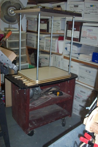

I also have to deal with shop space but you got me thinking(a dangeress thang for my wallet or whut's left of it) about building me one under my go bar deck which sits on a table with casters.... hum..

EXCEPT....look at my go bar deck
PostPosted: Fri May 12, 2006 8:10 am
John, it was just a glimpse of the idea but maybe you can help me with how to go about doin' this, i have a hard time seeing the radius dish being pushed with go bar rods without affecting the shaft a bit. I guess the shaft would have to go through both plates of the base of the deck, would 1/2" shaft be strong enough or should one aim at 1" shaft? oR MAKE THE DECK REMOVABLE BUT ABLE TO SIT ATOP THE SANDING DISH ? dANG CAP LOCKS! Serge Poirier38849.7179976852
