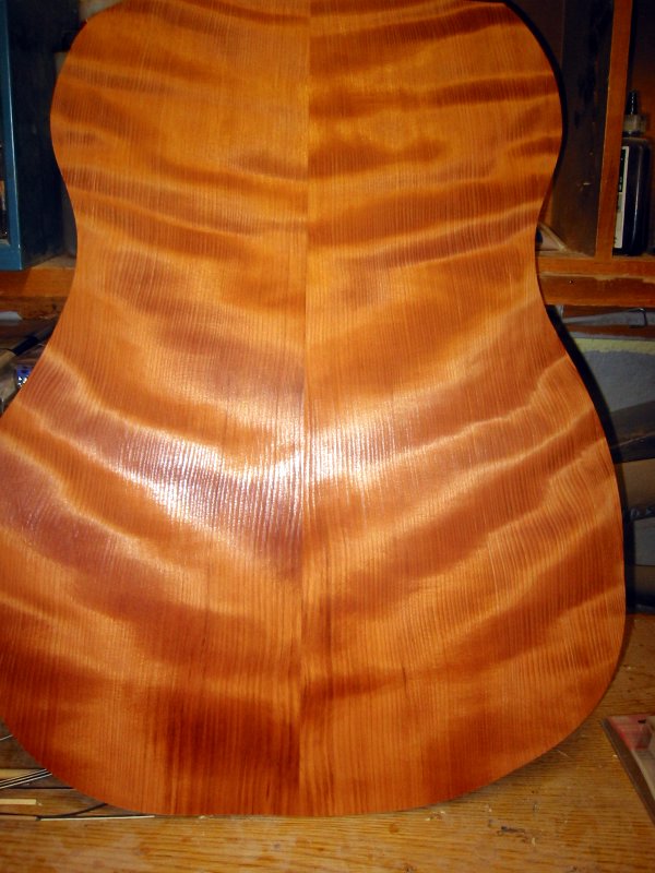

I bought a beautiful redwood soundboard set from Bruce Dickey and did some work on it this weekend. Now here is the question: I thought I did a good job of bookmatching during glue up. Used the center grain toward the bottom which matches up perfectly and when it was rough sanded I thought the flame was also aligned.
Did a rough profile and then sanded on the Performax. Next sprayed a couple coats of Shellac in preparation for rosetting. Once the shellac was on it, the match didnt seem right.
Did I screw up this beautiful piece of wood or is it common that the flame wouldn't line up while the center grain orientation did?

Rich your top is fine. It's natural for curls to look light on one side and dark on the other side because the fibers are angling out on one side and plunging down on the other side.
Looks like a match to me.

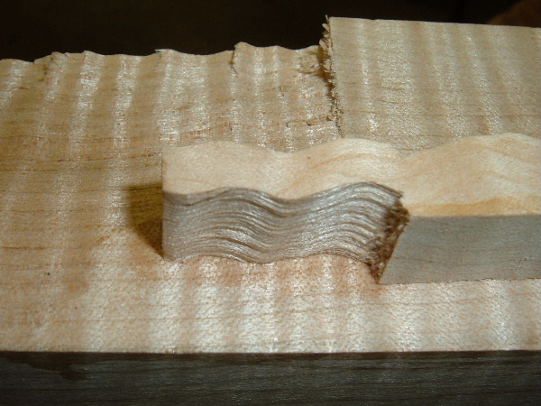

Rich, study the finished photo of Hesh's redwood top carefully. It's not so much out of alignment as one side is positive and one side is negative (so to speak). Redwood and other curly woods get the figure "play of lights" look from light refraction bouncing off the side walls of undulating grain structure. Bookmatched, one sie will refract opposite of the other. Here's a photo of what fiddleback maple grain (undulating) looks like. Imagine sawing straight thru the undulations. Hesh's top is almost dead matched, but with opposite refractions.

I've enjoyed working with this redwood. And it does exactly as you guys say, it reverse refracts from side to side. Very similiar to what happens on a Sitka top with run out, one side is light, the other is dark. Flip the guitar 180 degrees and the color changes exactly opposite of the way it was before turning.

It's funny how the light will make it look a little off. I think yours will be fine Rich,looks good

What Larry Said. It's totally normal; I'm used to the look because I've handled a boatload of maple tops which do the same thing.

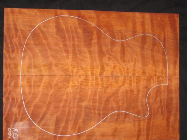

Um, if it's been matched properly, it's usually marked on the 'face' side, and looking at it will show you the rest. A smoothly planed surface shows off the figure really quite well.
PostPosted: Mon May 15, 2006 10:51 pm
One would think that simply by lining up the ends of the boards you could achieve a perfect match, but like it was mentioned above, the figure may move around when the board is sanded, or before that, right after its been resawn - just the 40-50 thou of a blade may show off the slant of the figure as it travels thru the board and thus, an adjustment of sorts may be required to line it up again as close as possible to glue - but once you start to plane/scrape/sand to prep the wood for finish it will likely be moving again. No one ever said mother nature had to be perfectly bookmatched !!!! Perfect examples o fhtis usualy occur in bearclaw -the runout has to be almost zero plus the claw has to run at perfectly 90 degrees to the grain lines or it will NOT be bookmatched - happens alot I find.
