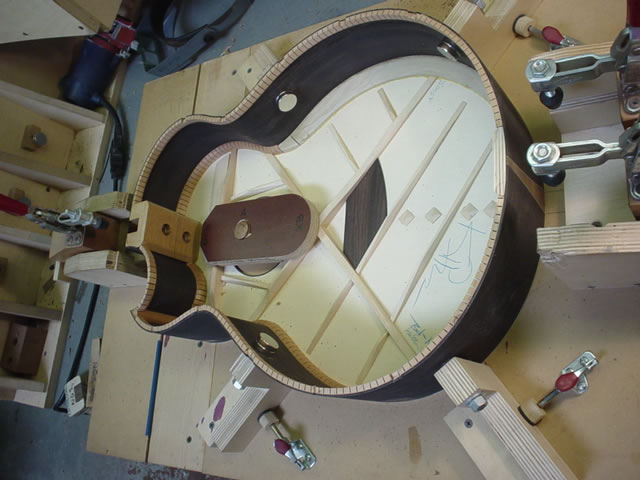

I just never cease to be amazed by Kevin Ryan's ingenuity. Look at what he is using for spreaders in this picture. What a clever idea.

Rare Earth magnets! cool MichaelP38853.458275463

That is pretty cool. I didn't think those magnets could exsert so much pressure...

Contrare they are very strong magnets for their mass. that is why they work so good on top crack repairsMichaelP38853.469375

Ill say thats cool - strong little buggers,
Im also really impressed with the rare earth magnet remote control sander on FRETS, too cool -
a drill with a circular disk padded with a thin layer of felt spins on the outside of the guitar, while a series of rare earth magnets glued together into a larger surface backed with sandpaper,
spin remotely in a circular motion inside the guitar.

I had a thought. Imbed Rare earth magnets in to my assembly molds at strategic locations and use the same principle via my molds. Hmmmm Thanks Kevin. Oh yea and you to Brock

Very cool idea. Nice bracing concept also

[QUOTE=Alain Desforges]   That is pretty cool. I didn't think those magnets could exsert so much pressure...[/QUOTE]
You have obviously never gotten you finger pinched between two of them when they make contact. Now that'll raise a blood blister might quick.
I think if I were doing that with magnets, I'd want some sort of caul spanning the whole height of the side. Seams like pulling on just one small area might want to distort it a bit.

[QUOTE=Pwoolson] [QUOTE=Alain Desforges]   That is pretty cool. I didn't think those magnets could exsert so much pressure...[/QUOTE]
I think if I were doing that with magnets, I'd want some sort of caul spanning the whole height of the side. Seams like pulling on just one small area might want to distort it a bit. [/QUOTE]
That is what I was thinking. Use the smaller ones. One high one low and one in the middle and caul plate with other small ones in itMichaelP38853.5339699074

[QUOTE=MichaelP] [QUOTE=Pwoolson] [QUOTE=Alain Desforges]   That is pretty cool. I didn't think those magnets could exsert so much pressure...[/QUOTE]
That is what I was thinking. Use the smaller ones. One high one low and one in the middle and caul plate with other small ones in it[/QUOTE]
Those look like two magnets stacked. A 1 inch magnet has is about 30 pounds, so that is a lot of clamping pressure. I'm wondering how he safely removes them without damaging the sides.

You just slide them off carefully i'd just say. Same approach when you install them in, you have to start further away and gently slide them towards the clamping point.

Rare earch ones are frighteningly strong. One store I'm looking to buy some tiny ones for (to fix electric guitar cavity covers) has ones that are 1.25" in diameter, 1/8" thick, and can pull about 55lbs or so. Some of the larger square ones cost absurd money can pick up a good 250lbs or so. A few german webshops have them for about 2.50 each, might be an idea to embed some in my molds. Hmm....you really want to keep them far, far away from your credit cards, though.

Michael, I love your idea. But maybe a better idea is to just embed pieces of steel in the mold, and then use magnet-loaded cauls inside the guitar.

[QUOTE=Scott Thompson] I'm wondering how he safely removes them without damaging the sides.[/QUOTE]
My guess is that he releases the toggle clamps and pulls the bracing post away from the side and the magnet just falls off.

[QUOTE=LanceK]My guess is that he releases the toggle clamps and pulls the bracing post away from the side and the magnet just falls off.[/QUOTE]
Maybe not, Lance. I think doing it that way would pull the side along with the bracing post. Might even crack the wood. Sliding the magnet away from what it's attracted to is probably the way to go.
