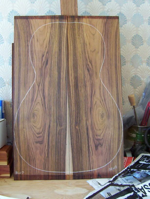

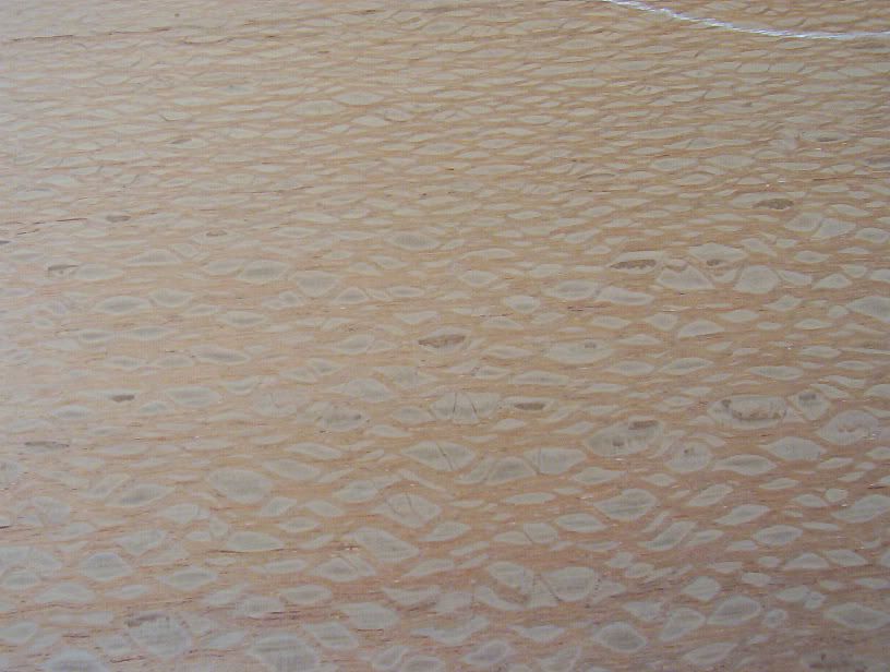

Also Toddstock and everyone else - very helpful tips! Exxxxxxxxxxxcellent Smithers, my mind is racing with the possibilities now - I wanted to show a really nice set of lacewood I got - it Bolivian, I believe, and more of a teardrop shape with regard to the figure spots than just the more boring oval which is mainly what I have seen in the past.
Charliewood
PostPosted: Mon May 15, 2006 4:10 am
First off my camera sucks - its like 10 pixels, LOL - its horrible - 2Meg, andhow this will give you a rough idea of what I am working with, also I wanted to know if the lacewood paterns on my set are common I have never seen them like this but that doesnt mean anything?

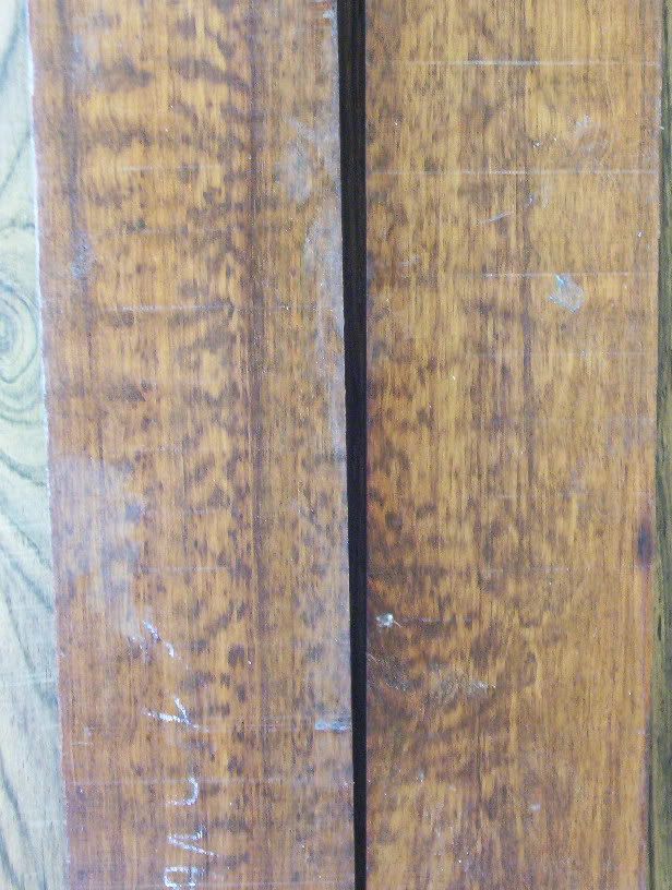

The proposed fretboards #2 snakewood - thanks Brad!
The lacewood pattern - I like it - Ive never heard a lacewood guitar I dont think - tonally what does it equate to? Maple? feels light!

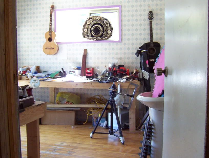

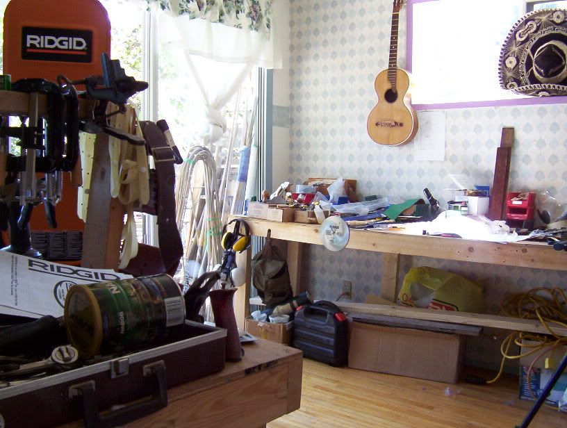

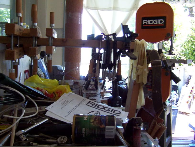

My mess
more mess
still more mess
what a view though

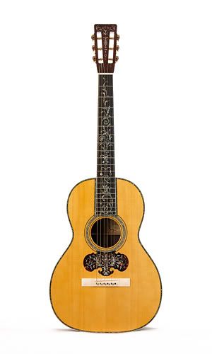

That picture of the Martin is a OO....your set is too small for that, but a O or size 5 would be great for that set of BRW. Speaking of the BRW, it looks a lot like Pau Ferro! Don Williams38852.6585648148

Thats funny the web I got the picture off of - listed that model as an 0-45 - so I dunno.

Don W, I looked it up, cause I was curious as to why the guitar would be mislabled on the webpage when it was the profile - and its not because I doubted you - upon further reflection I was like that IS a OO-45 style, so I sifted to the page and lo and behold its an O-45 thats a proportionately minuiaturized OO-45
Cool huh?
heres the excerpt
This was also the same year that Martin was busy making a limited amount of their presentation grade 0-45 guitars (42 to be exact, available for the purchase price of $155). This 12-fret guitar's back and sides are constructed of Brazilian rosewood, and the top is made of German Spruce, featuring a shellac finish. This 0-45's top, back, and sides are outlined in pearl. The 24-inch scale fingerboard has bar frets and is inlaid with snowflake position markers. The headstock sports the famous torch inlay and engraved Waverly tuners with ivoroid buttons. The size 0 model has a smaller yet proportionate body shape, which gives the instrument a beautiful balanced sound that projects a loud, commanding tone
