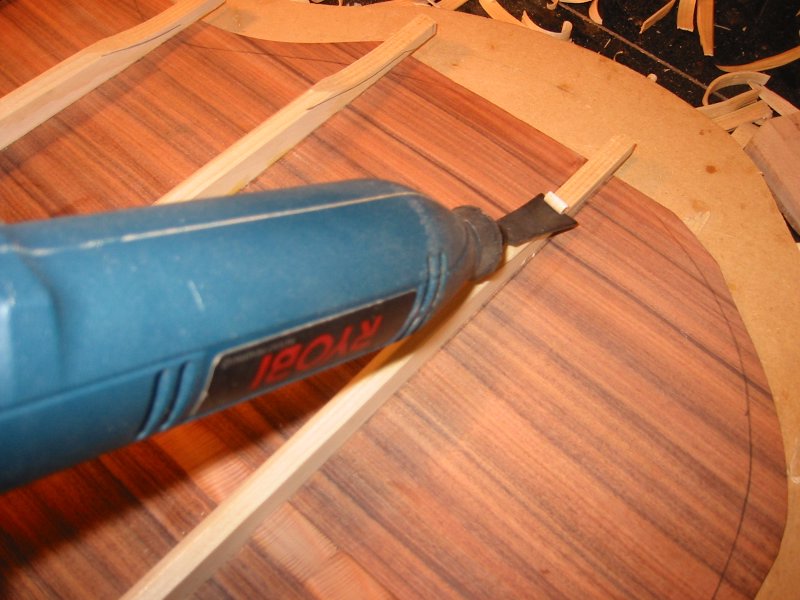

This might almost be like cheating but I picked up this electric chisel/carver at a garage sale and it gives me unbelievable control.
