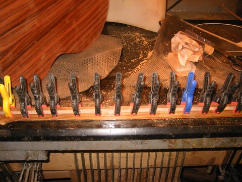

I do it two different ways.
For the purfling that will show on the sides, I glue it to the binding using Titebond II. I have a bunch of the little black clamps with orange jaws, and I clamp the entire strip, setting the clamps almost right next to each other. I use Titebond II for this because it's water resistant, so when I go to bend the binding/purfling, I can spritz it with as much water as I need during bending, and I don't have to worry about the binding/purfling separating when bending. When I used regular Titebond, this was a frequent problem.
I like to leave the binding and purfling a bit wider than final width, so that after the glue has dried, I can pass the pieces through my drum sander and sand the purfling and binding flush with each other.

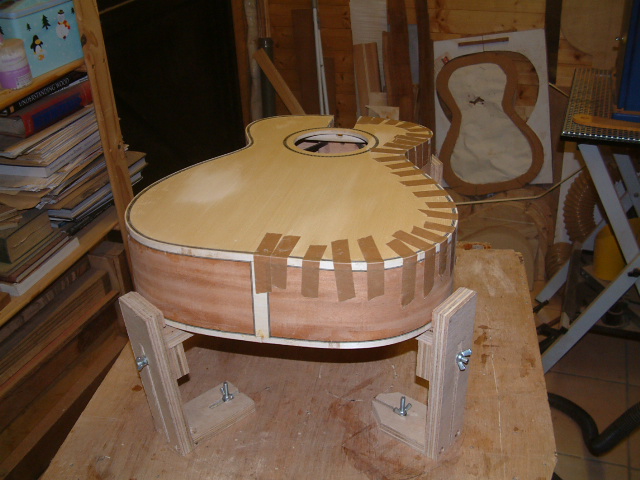

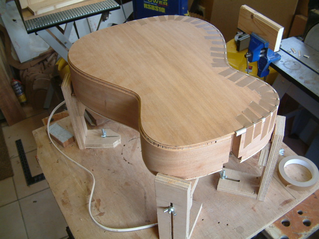

I do it pretty much like Michael except for the top/back purfling. Like Michael I cut the binding and purfling channels. Then I do dry fitting of the bindings and purflings using the brown tape that Stew Mac and LMI sells like I would if I was doing the real glue up:
This dry fitting lets me do all the cutting mitreing etc of the bindings and purflings and lets me check how they sit in the routed channels so that I can make any fine adjustments and make sure that all joints/mitres of the binding and purfling join properly. I do lots of dry fits until I'm happy and get through lots of the brown tape (fabulous stuff) but it is pretty cheap stuff. Be syre to heve the top sealed (I use shellac) so that removing the tape doesn't take out any top wood fibres!
Then when I am happy I do the full glue-up. I use Titebond and put some in the binding/purfling channel and a smear on the back of the binding - no glue on the purfling. I fit the binding and top purfling together (one at a time, 2 top and 2 back) and use the brown tape to hold it to the side and top, cleaning up/rubbing the glue into the purfling and side as I go. The tape pulled against the binding and onto the top holds the top purfling tight between the binding and top:

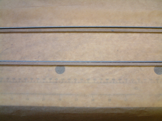

I recently went through this process and here is what I did that worked very nice.
Took a scrap piece of pine and routed a rabbit on one edge to the point that the purfling and binding combined stuck out just a hair beyond the rabbit. Used like a 3/4" wide pine board. Applied some plastic shipping tape so the glue wouldnt stick and glued up the binding, added the purfling and then clamped with small clamps. Worked great.
Here is an image of the purfling and binding being set into the rabbit.
Picture of clamping
So simple!!! Made two jigs in 5 minutes so I could do two at a time.
Make sure to let the binding extend just slightly beyond the rabbit so when you clamp you are clamping the binding and not the jig

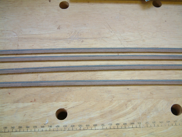

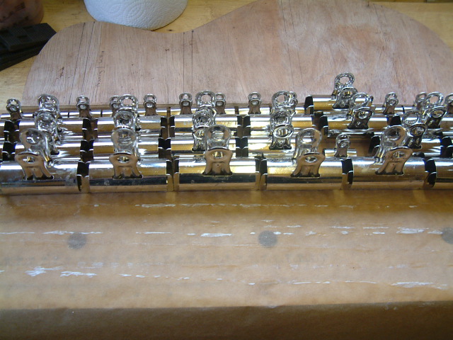

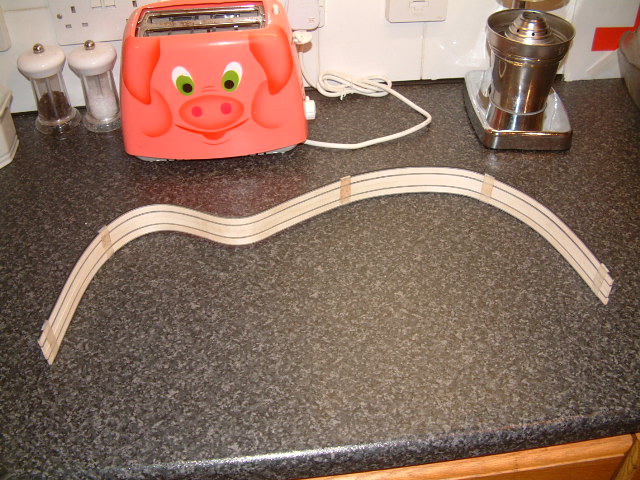

As I said I do it like Michael. I glue the side purfling to the binding using Titebond II and clamping with lots of small bulldog clips (I think you call them Boston clips?):
The glued purfling/binding is then scraped level. I then bend them in the Fox bender - all 4 strips held together with masking tape making sure that the purflings don't touch on each strip (and that you have the 4 pieces bent the right way damhikt ). These are a different st of bindings than the first pictures:

PostPosted: Sun May 28, 2006 2:44 am
Nice toaster Dave!
PostPosted: Sun May 28, 2006 3:00 am
[QUOTE=L. Presnall] Nice toaster Dave! [/QUOTE]
Larry,
You've never bent your bindings in a toaster??
PostPosted: Sun May 28, 2006 3:43 am

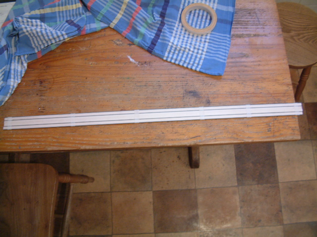

PostPosted: Sun May 28, 2006 10:06 am
I just wrap them with some masking tape until the glue dries. Tape the purfling to the binding at each end first with a small piece of masking tape, it helps if you flex the binding a little so that the purfling has a little bit of tension on it. This helps it to lay flat against the binding. Then just run a small glue brush between the binding and purfling and wrap pieces of 1 1/2" wide masking tape around it. Once the middle is done you pull of the tape at the ends and glue the ends up. Easy
