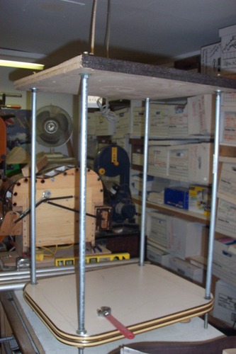

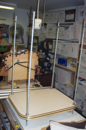

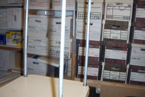

Hi Michael!
Here are a few shots of the construction of my deck, based on the model that Pat Foster showed here, it is very sturdy on both the top and bottom, 2 plates each were glued and 4 --1/2" theaded rods inside tubing and nuts to make it all secure

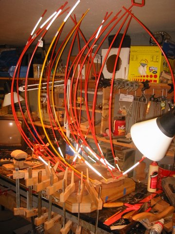

Here's mine, it's part of my bench area and the underside of my loft

I found that by using tubing as spacers between the top and bottom, such as Todd has, and putting them under compression from the nuts, the deck was less wobbly, though strength is not affected. The spacer on the bottom is used when gluing braces and is removed for gluing the top and back.

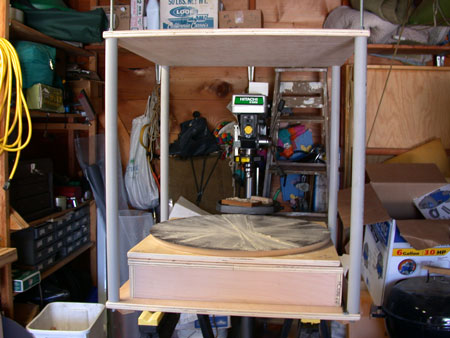

I had one of the threaded rod types originally as well, but it was always geting in the way, plus if I took it apart it was always a chore to make it up again. So I dropped the top deck off the floor joists above my router table (its big) and then use that as the lower deck. I made a couple different risers to accomodate the differences in just gluing braces, or gluing a top or back onto a rim (both including bowls). Now its always there, and with the risers can be set up in a minute. If I ever do it again, I would make it double width though. It also doubles as a high shelf for storing (losing) stuff !!! Just made a purfling cubby hole boxfor up there to control the out of controlness of all that stuff (48 slots). You never knew if there was any single blk lines left without taking out a whole bundle of assortments.
