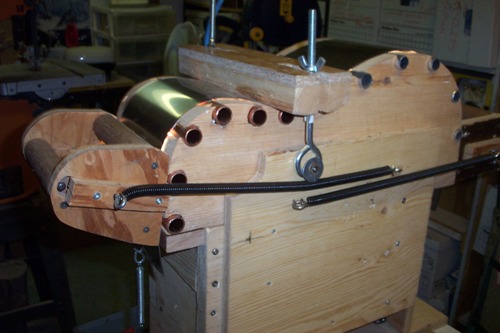

Rich, here's mine that i built from Jc Jones and other's models, it uses 3-200 watts bulbs, i purchased the blanket and controls from John Hall, works like a charm.
Make sure to have the spring steel slats also!

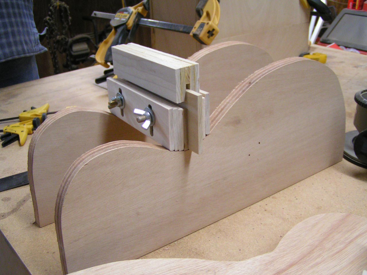

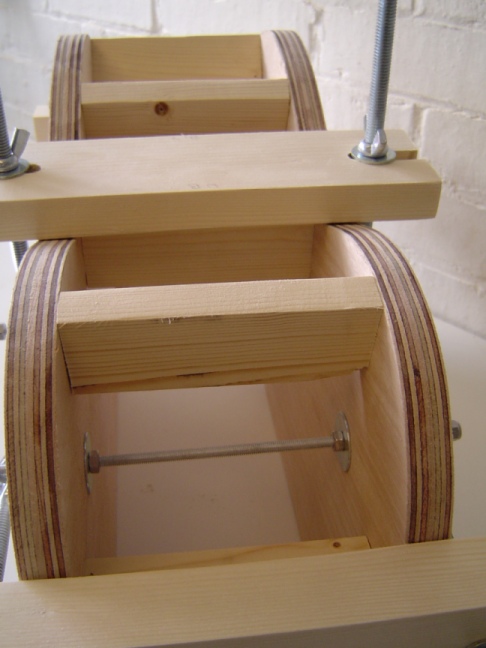

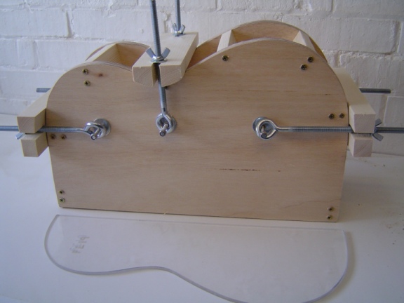

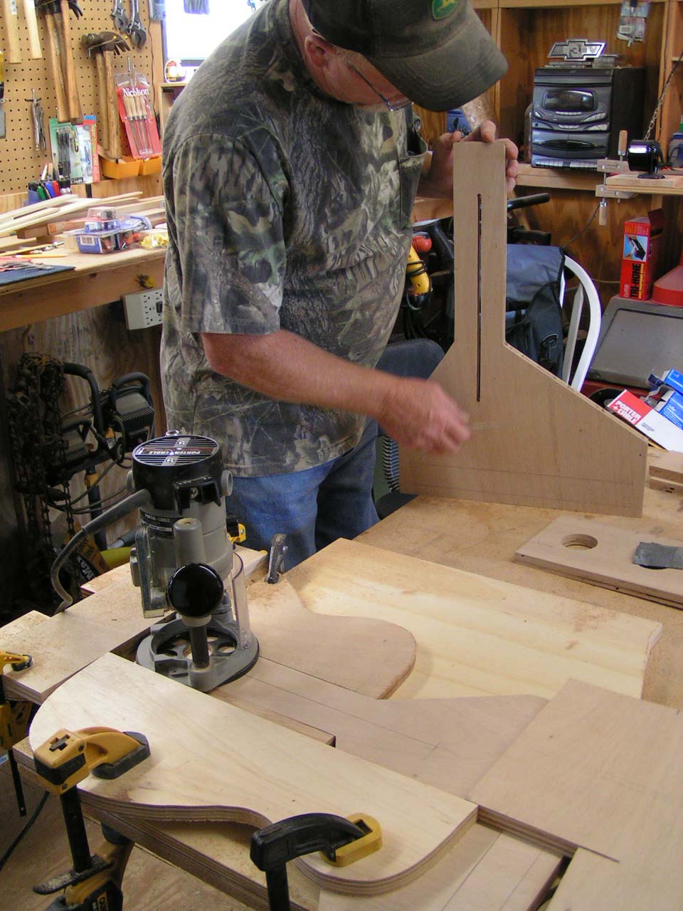

I build my own benders, I make a dedicated one for each body shape, apart from the hook eyes most parts come from the scrap bin. If you are going to make your own body shapes you'll need to build, or have specially made, your own form anyway. The whole thing can be made in a couple of hours.
I do use one of John's blankets/controllers and his spring steel slats.

Colin...Thanks for the great Pics. Looks like you did a real nice job on making them. Not too shabby considering the wood came from your scrap bin. I think I can take on project like that w/o to much grief...& save a little $$ as well.

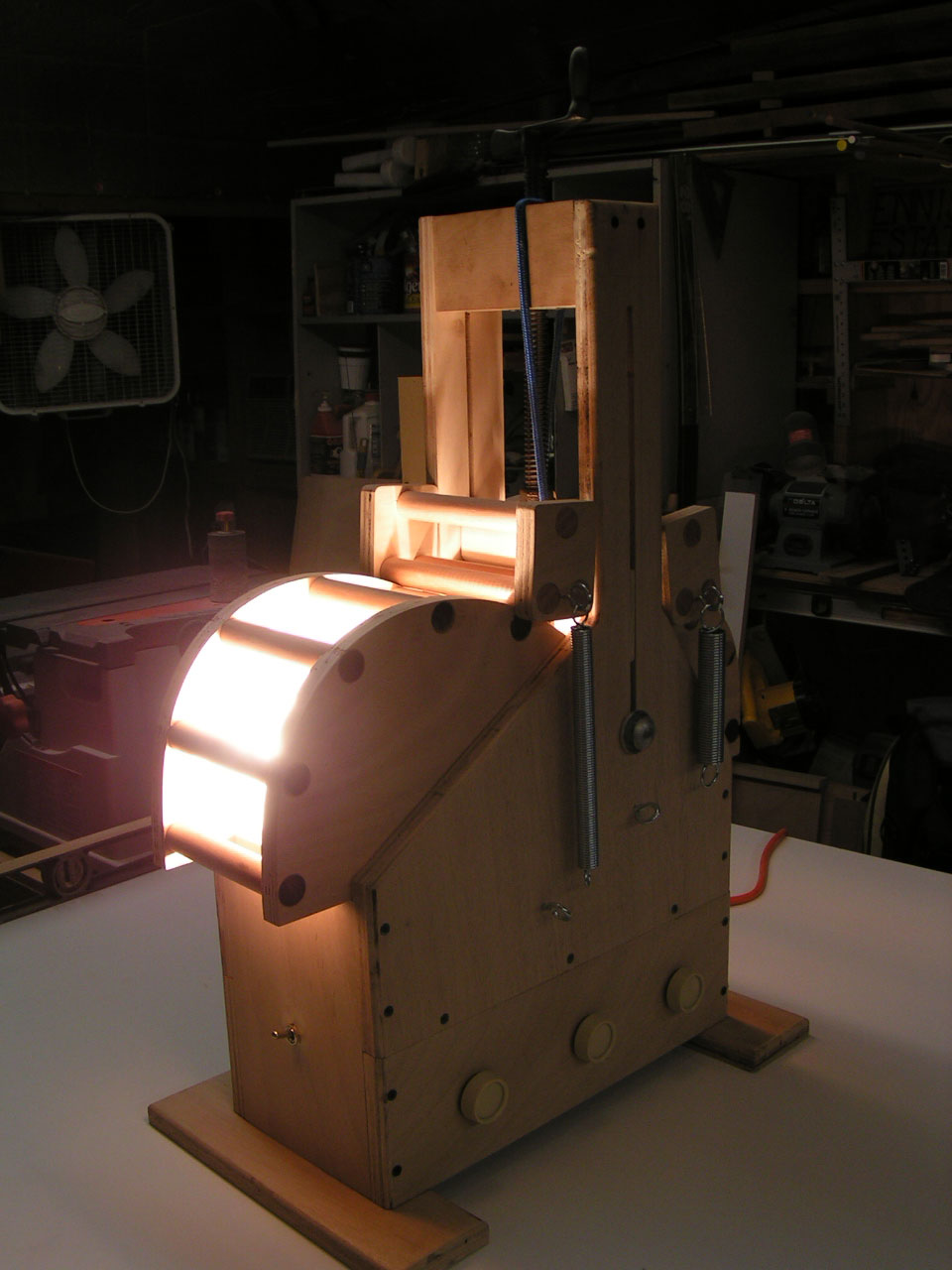

Me & my dad built ours from a set of plans he found on ebay for under a $100.00
we added a on/off switch & 3 seperate dimmer switches , to control each bulb temp better... nice
everything else is by the plans really
I think it turned out kinda rad, can`t beat the price awayway ....matt ennis

[QUOTE=Hesh1956] Colin very nice job on your benders!
Question: For the upper and lower bouts do you start the bend by hand (with gloves of course) before engaging the hold downs? If so this appeals to me greatly in as much as with the Fox style bender I lost the feel of the wood bending that I had on the pipe.
You bender seems like the best of both worlds AND it is so easy to construct that it encourages experimentation with different body shapes.
Hesh, yes I start with the waist taking it to within 1/2" or so then work with gloved hands on lower bout then upper bout, smooth down using the cauls then bolt down lightly before finishing off the waist. Then tighten up the upper and lower cauls.
I cut the sides using the router table and a hardboard template then I use threaded inserts in the sides to connect them together, this ensures perfect alighnment (assuming they are drilled together). They really are simple and effective.
ColinColin S38869.2644328704

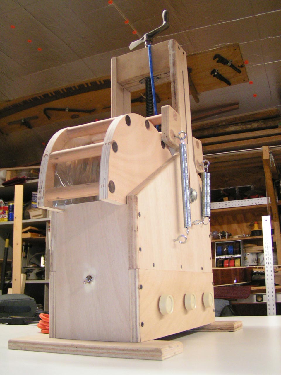

My bender was made from scrap plywood and in my shop based on pictures I found here and at MIMF. Orriginally it used lights but I now use a blanket. The bender cost me about $1.87 which included about six forms. Some of the forms are plywood, some MDF, I used hockey stick handles as spreader. Bent over 100 sides using this and still going strong.

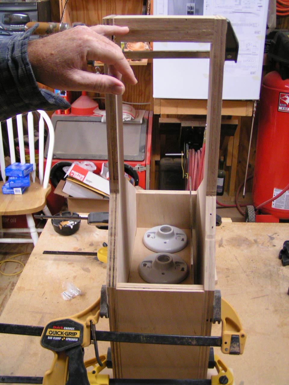

Here is the bender I use, built by a friend who is a welder.
John How38869.3775694444

Mattrix,
Are you getting enough heat to top of the form? It appears that there is alot of distance between the bulb and the top of the unit. I built one that looks similar, use 3 - 200W bulbs and mine are alot closer and I have many problems in getting my heat up to the 300+ degree point. I drilled a hole in one end of the bender box and built a mount to hold my heat gun. I insert it into the unit on low and now can get to the higher temps. Just curious about the height.
PS. I plan to order the blanket and one of John Halls when I save up enough pennies, bulbs for me have been a hassle with lots of problems getting enough concentrated heat on all of the upper bouts.
PostPosted: Thu Jun 01, 2006 9:41 am
Posts: 61
Hi Mike , to be honest with you we haven`t even used this bender as of yet. it hasen`t been completed to long .. but now that you brought the height issue up , i`m not sure if we will be recieving enuogh heat. I mean we are using 3 200 watt bulbs in a totally covered foil form. i dont know if this will help but we are hoping to test the new bender out this weekend. I will let you know how it goes , thanks for the height idea.
