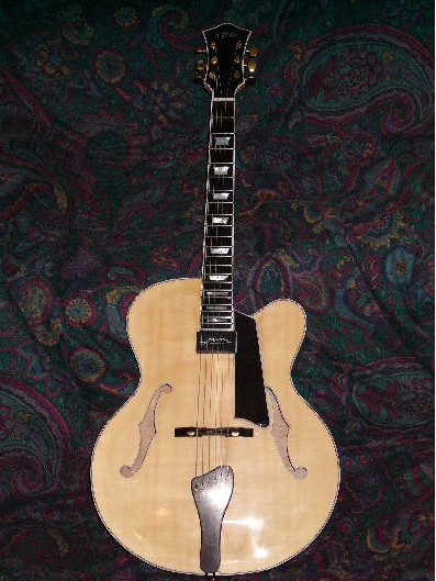

Here you go mon ami! Here's one I completed a couple of years ago.

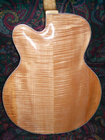

Ah! A guitar model!! Way to advertise, Anthony! Was carving all that maple a lotta work or a lotta fun?

Anthony! That is superb! Very very nice indeed... That maple is very stunning. I also like the natural colored finish. Not much tint, if any... Very tasteful.

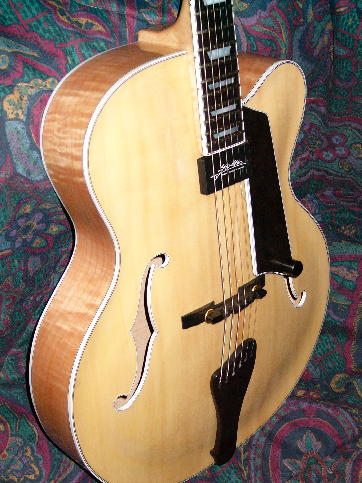

What type of pickup is that, Anthony?

Archtops get all the pretty girls! Nice work, Anthony! Thanks for posting. Is the bracing parallel or "X"?

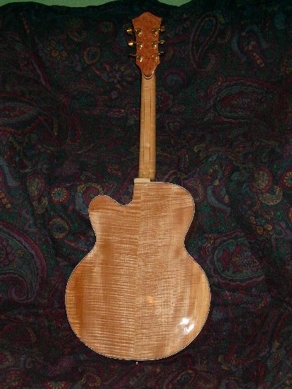

I picked up this maple from guitarwood.ca and it was actually his lowest grade of figured maple.
Larry - carving the maple wasn't too bad as I use an angle grinder with a Lancelot blade followed by IBEX plane, scrappers

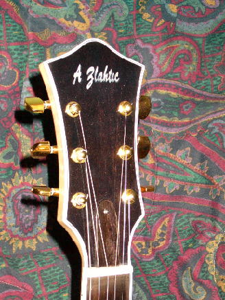

Arnt -- I'll try to get a photo of the backstrapping hopefully before this thread goes off the board. The backstrapping is B veneer/sycamore/B veneer/Maple burl
Nelson - the Pick-up is a floating Atilla Zoeller (I cut off the neck extension, laminated on a piece of aluminum with epoxy and then epoxied with a piece of carbon fibre cloth over top. I am not crazy about this pick-up in terms of sound. (BTW: You are an imp )
Alain - the tint is provided by blonde shellac from Lee Valley. It actually darkened the top more than you'd think as its Engelmann Spruce.
Carlton -- it is X braced

Ah Archtops -- they take easily twice as long to build, don't have the dynamic range of a good flattop, use three times as much top and back wood. On the plus side -- they are plenty loud, each string sings individually and more clearly than a flattop and dang they are pretty!Anthony Z38863.7953009259

Serge, figured maple is the traditional back/side wood with a spruce top. Historically euro maple and spruce was used. Given current availability and cost considerations most folks now use western Big Leaf Maple for sides/backs and Sitka or Englemann for the tops.
There is no reason why you couldn't use alternate woods for backs and sides. I've seen Archtops made from:
- Koa
- Black Acacia
- Walnut
- Mahogany
- Yellow Birch
You could use Sycamore. I am not familiar with white or black ash as a tonewood. My suspicion is that it would be difficult to find it in sufficient width to build a two piece backed Archtop with a 16", 17" or 18" lower bout.
