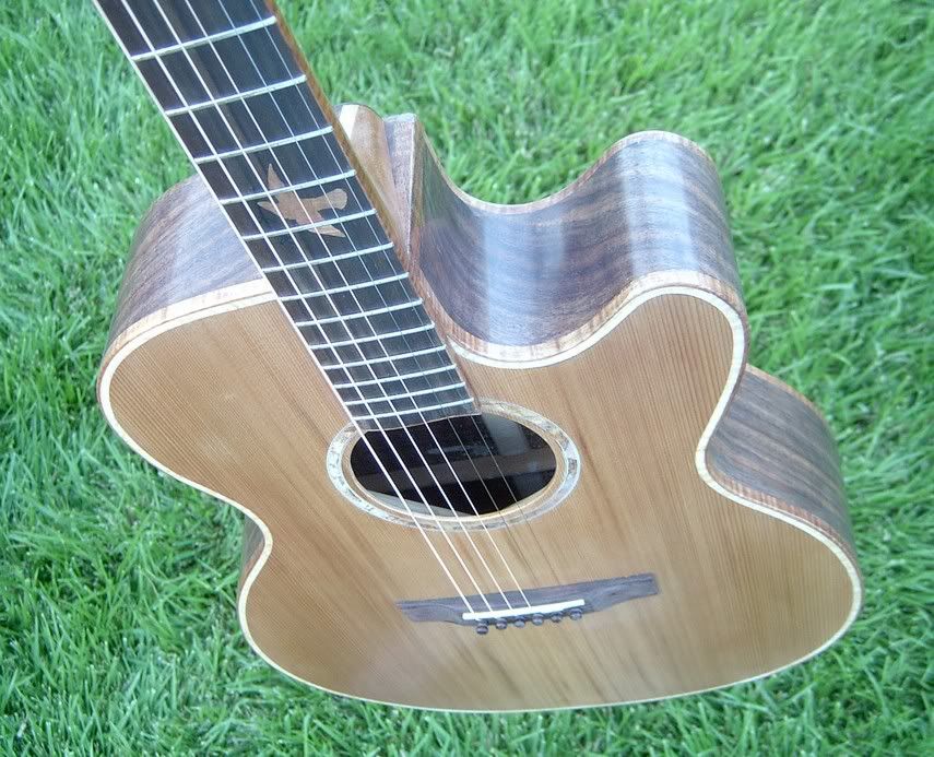

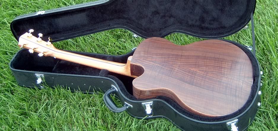

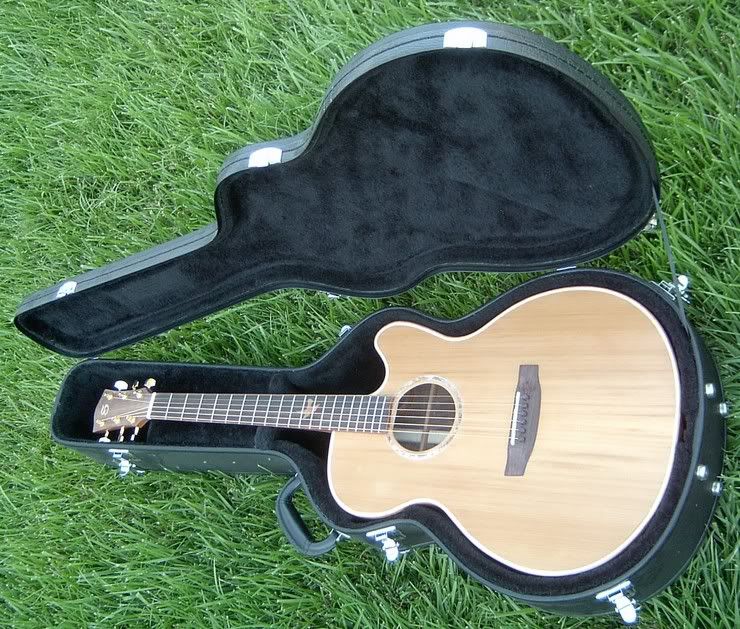

This has been my most difficult build, mostly because it was my first Venetian cutaway. I made the radius too small. While the walnut side bent easy enough, the koa binding and the maple purfling was a real pain. I had to do it twice. Then I sanded through the binding on the back and had to do that over also. Anyway, it plays and sound very nice. It is cedar top on walnut, with koa binding, maple purfling, spalted maple rosette and butt wedge. The finish is satin water based.

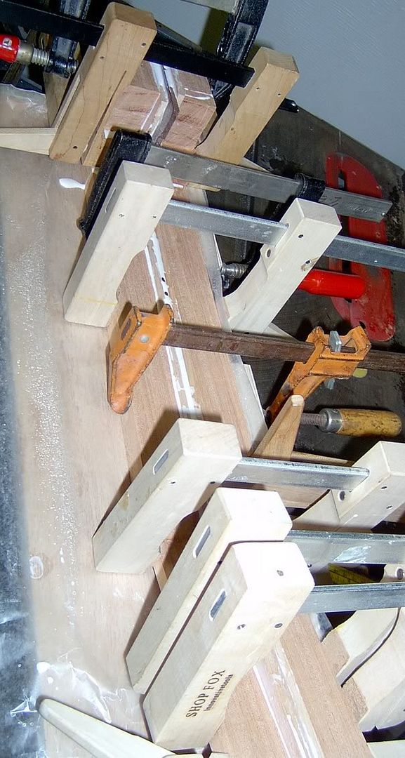

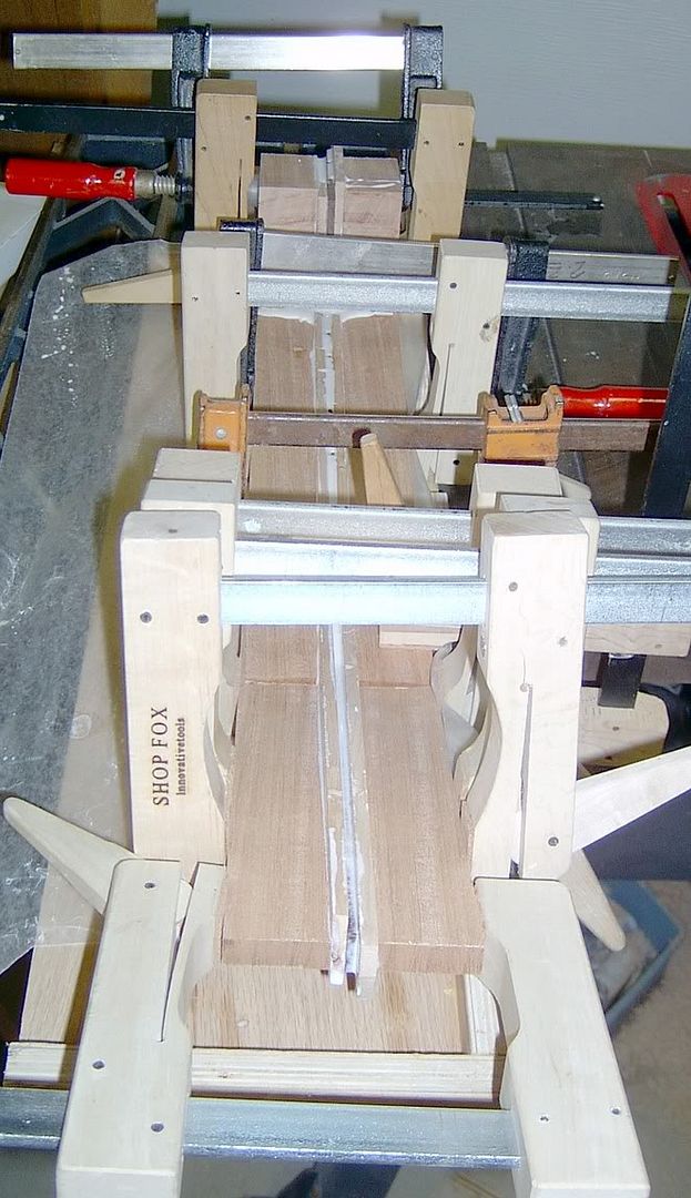

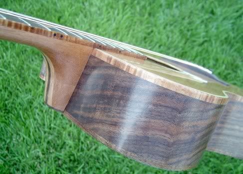

Very nicely done . It looks like you used a stacked heel on the neck. How did you keep the contrasting wood lined up?

Very nicely done . It looks like you used a stacked heel on the neck. How did you keep the contrasting wood lined up? [/QUOTE] I'm sorry I don't have many pictures so I'll try to 'splain it.
I build up the mahogany with the heel and angled headstock.
Then I saw it in half and run it through the belt sander to square and level it out.
Next I prepare the inner strips with the heel block and angled head stock.
Then I glue up the 5 pieces.
It took me a while to develop the process.
It makes perfect transitions.
Here are some pictures of the final glue up -

Very nicely done. Looking at your cutaway, I can imagine the trouble you must have had bending all that stuff--especially the maple. I've done a couple of necks just the way you pictured yours, and they do look nice.
