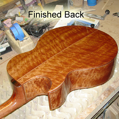

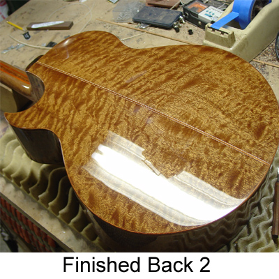

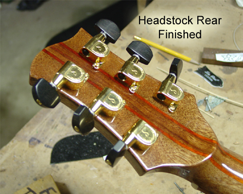

    Here are a few photos of the African missions guitar. The finish is complete and will probably just get a light wet sand and buff after about a week to smooth it and address any small areas that need attention.
    Inlay is still up in the air, but the Elephant ivory as material is out. I did some checking with folks at the African embassy in Washington and they informed me and advised me that its use would not be the wisest or most politically correct decision on my part.
   Something simple and elegant is probably going to be used to keep the guitar attractive to as broad a base of players as possible.
Thanks for looking again,
Kevin Gallagher/Omega Guitars

PostPosted: Sat Jun 03, 2006 4:30 am
Posts: 542
Awesome guitar!!! I love it!!! The finish looks fantastic! What kind of finish is it??
PostPosted: Sat Jun 03, 2006 5:59 am

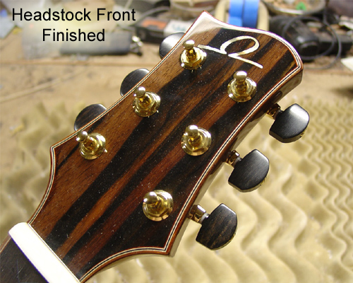

Man, now that is one alpha Omega! A guitar like that don't need no stinkin' inlay! Seriously beautiful!
PostPosted: Sat Jun 03, 2006 6:12 am
Posts: 1041
Carlton,
   I had considered a blank fingerboard, too. When I build instruments for myself, that's what i usually end up with. I'm just not sure yet on this one.
Colby,
The finish is a UV cured polyester finish. It's the same finish being used by Ryan, Olson, Collings, Taylor and several others. A 20 second cure under the high intensity UV light is equivalent to about 30 days of dry/cure time for lacquer.
   It is many times more durable than lacquer and because of that toughness, it can be applied thinner and lighter while stll providing good protection for the guitar.
   Another great feature of the finish is that it will never check or crack like lacquers and other finishes do with time and the expansion and contraction of the woods that occur with temperature and humidity changes.
   It can be age toned to give a warm vintage look right off the bat, but it will not develop that amber aging that occurs with lacquers. It will look the same in twenty years as it does the day it comes out of my spray booth. I lke that clear, tranparent appearance, but some guys like a more aged look so we give to them on a brand new instrument.
Regards,
Kevin Gallagher/Omega GuitarsKevin Gallagher38871.6356712963

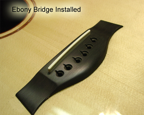

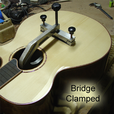

PostPosted: Sat Jun 03, 2006 6:38 am
Posts: 271
Location: Cudjoe Key Fl
Great looking guitar...
You drill and slot the bridge after you gule it??
I slot mine but do the drilling on the drill press before gluing. What is your advantage for diong it that way??
Gary

Gary,
I like to drill and slot them on the top, but don't always do it that way. I keep about 500 bridges ready to go on guitars here with slots and holes cut already, but strayed a bit from the typical footprint of my bridge on this one. I changed it a little for no other reason than to make it unique with a slightly deeper belly on it while I used a slightly smaller bridge plate to balance the addional material, weight and stiffness.
I used to slot and drill on the guitar all of the time. but for no other reason than that I enjoyed doing all of the locating off of the fingerboard approach. No real benefits or advantages, but it works just as well as doing it before. When I drill the pin holes before the bridge goes on, I only poke them at 1/8" so there's plenty of material to cut the pin taper into afterwards.
   I just cracked open a bundle of Brazilian Rosewood bridge and fingerboard blanks that I've had on a shelf here for ten years so I'll be machining them in the next few weeks and will slot and drill some and leave others cut to shape without the slots or holes.
