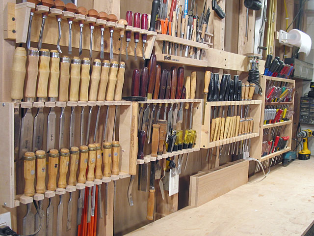

What sizes? Duh....as many as your wife will either approve or not notice!
Seriously, I would suggest having two or three each of the 1/2" and 3/4" (so you always have a sharp one), and then an 1/8" and a 1 1/4" or so.

Hesh, I'm actually not a very organized person, but as you know (probably better than any of us), the more stuff you have in a small space, the more organized it needs to be if you expect to accomplish anything.
Colin, no.
Some guys like coins or stamps or baseball cards. I like chisels (and industrial robots).
John Watkins
