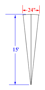

I'm looking to make a bracing jig and need to make the radiused pieces. There are a ton of places that sell radiused templates, but I was wondering if anyone has a "simple" way of drawing a large radius? I know the math behind it will vary depending on your jig size, but wanted to see if someone has an easy way of doing this.
The sizes I'm looking to make are 15' & 28' for a bracing jig. It looks like the length of my pattern is going to be around 24" long.

   Other than trig plotting or a pencil with a tape measure, I don't know any! The chordal height would be a difference of about .400" at 12"/15' is this what your looking for?
    I don't know how accurate you have to be for braces but you could print a radius from a graphics program, that matches a 6" segment of the radii, and use that for a pattern.

I use a fiberglass go bar, bent between to pins set at each end of the 24 inch distance on the 2x4 that is used to make the rails - math will tell you what the height of the arc needs to be, then you flex the rod to that distance and draw a line - cut, smooth the arc, then split the 2x4 - you now have matching rails for the routing jig to make the bowls.
Here are the needed numbers: arc height for a 24 inch curve
15 ft - .4 inches
18 ft - .33
25 ft - .24
28 ft - .21
Happy dust making - MDF is awful stuff!!!

Its really pretty easy, although messy. I used a method similar to Tony's. I had a piece of square steel rod (1/8 inch I think). Put two nails 24 inches apart in a piece of plywood that would be the pattern for the rails. Bend the rod by the amount needed to make the desired radius and trace a line.
Use the plywood as a template to make a second rail (splitting a 2X4 is a good idea if you have a table saw). Use the rails to make a jig for your router to ride on. Set the jig over your piece of MDF and route out the inside of the bowl. Do this outside and use a dust mask. It makes a ton of MDF dust that will go everywhere.

If you have access to Adobe Illustrator, draw a 12 inch diameter circle.
Cut off most of the circle so you are left with an arc you think will
ultimately be long enough. Multiply the arc by whatever radius you want,
say 25, and the resulting arc will have a 25 ft. radius. You can't enlarge
the circle first and then cut it to the chord length you want because
Illustrator won't let you make a shape that large. That's why you need to
remove the unwanted part of the circle first. Then just print it out on 8.5
x 11 sheets and tape them together, or take the file to Kinkos and they
can print them on big paper.

I'm definitely going to try the idea of marking two points 24" away from each other, mark the correct height for the middle point, then bend something to make the curve.

I just tape the end of my tape measure to my drill press and pull the tape out to whatever radius I need and use a pencil held with the tape measure to move and mark through an arc. Very simple.
