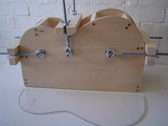

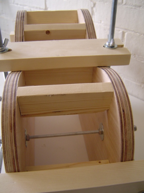

I've posted these here recently, they are made from 3/4 ply but you can always glue two layers of 1/2" ply together. They can be made in no time at all, I use a table router and template to cut the sides. I have bent something like 50 sides using them with silicone blankets and spring steel slats, using my gloved hands, and never had a side crack.
OK, ideally you get a full, all singing all dancing Fox style bender, (Or maybe one of Taylor's) but these will get the job done.

Colin Your bender looks a lot like mine.
PostPosted: Tue Jun 06, 2006 2:35 pm
I do mine just like Todd said. Works great.
PostPosted: Tue Jun 06, 2006 2:46 pm
I think i'll do like Todd too, looks easier that way.
