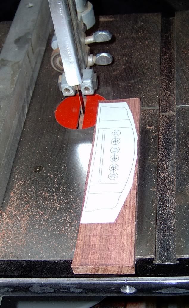

I start with an AutoCad print out of my design.
I cut out the bridge blank and attach the design with spray contact cement.
Then I band saw off what I can....

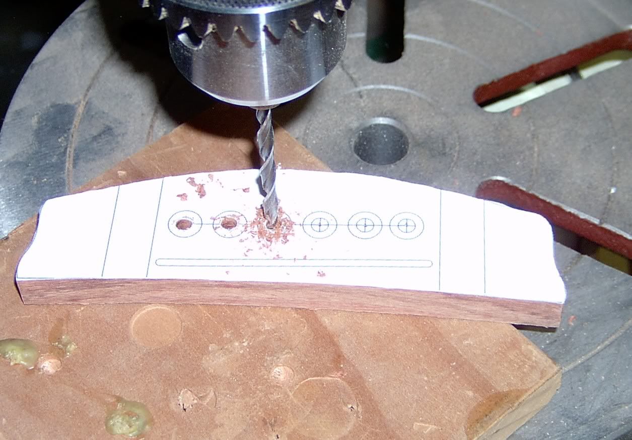

Next I drill the holes. I center punch on the cross mark for accuracy....

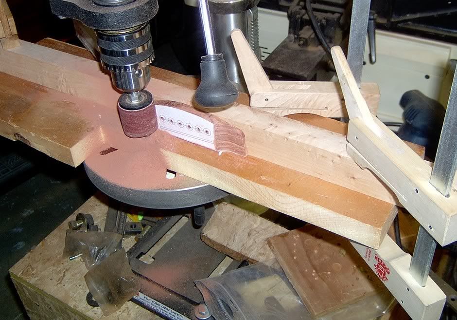

Then I set a fence on my drill press to sand the curves into the wings.

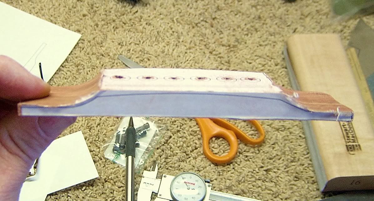

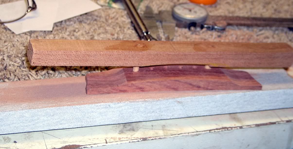

Next I mark the bottom of the bridge with a white pencil and sand the radius on the bottom.
All that is left to do is sand the 16" radius on the top, chamfer the holes, remove some of the bulk off the back, break (soften) the edges, sand and polish.
