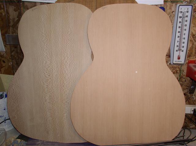

Has anyone here ever built a guitar with a douglas fir back and sides? One of the wood advertisers on this site at one time had a back and side set for sale. I can't recall what one. The Pic wasn't that clear for me to really see what it looked like. I would like to see a guitar built with this to see what it looks like. Growing up the only fir I seen was the type used in studs and home building. I remember it having a large standout grain with a very rustic look. Does anyone have any pics or a websit they can point me to of someone who has built with this. I have checked the archive but only found mentioned in passing....Thanks

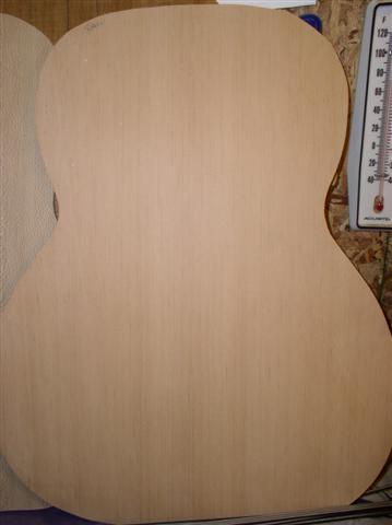

I wish I could comment further on Dug Fir, but I am in the process of building my first from it, and only as a top wood. I can say that it is very stiff along the grain, and has a nice ring, also the color (beige/tan) looks real nice. I'm pairing it with a set of Sycamore with a walnut neck and Tx ebony bridge/fretboard and overlay. So this will be my first all domestic wood guitar.

I have a set of the extremely fine grained Doug fir that BobC had some time ago. I haven't built with it yet but will someday. The grain is so fine that I can only estimate 30 to 40 lines per inch. Pretty stiff but maybe a bit brittle like some redwood can be.
Lance, I'm sure you know this having built with redwood many times, it might be a good idea to give ita good coat of schellac or two before doing any routing on this stuff to help keep the chipping down.
