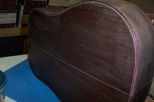

Hi Folks, after my latest developments were made, someone was kind enough to let me know that i had forgotten to install a wedge on my guitar and now, the binding and purfs are on so i'm kind of in a delicate situation here. Could you show me some of your wedges so i can get ideas on how to go about makin' mine, i want to know what would be the best route to go with what i've done so far! Here's a pic showing my situation
TIA

Serge, I'd go simple. Use a leftover piece of your binding, rout very carefully and glue it in. You might be able to fill any mismatch with PH sawdust. If I were routing it, I'd place a stop block on either end of the channel so the bit couldn't get into the binding. I haven't had to do this exact thing, but that's what I would do. I route my groove before attaching the top and back. I advise you to wait for several opinions, though, so you can't just blame me.

The stop block is a definite must have. You'll have to rout shy of the binding and excavate the rest by hand.

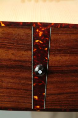

I'd also try to keep it plain and simple, seeing as you have a delicate routing operation ahead of you! Here's my very simple latest.
Good luck budy!
PostPosted: Wed Jun 07, 2006 3:02 pm
My advice would be to use a piece of binding. I cut mine by hand with a steel rule and a box cutter the excavate with a 1/4" chisel. Many light cuts with the box cutter give much greater control than one or two passes with lots of pressure. I'll post a pic of my latest when I get home from work.

Could it be also possible to route trough the binding and have the wedge get flush with the top and the back?
Would it look too weird?
PostPosted: Wed Jun 07, 2006 3:26 pm
If you make it flush with the top and back, then it will be darker than the binding when looking at the guitar from the top and back, 'cause you'll be looking at end grain which will finish darker than the rest of the binding.

I'd go as simple as possible Serge. Just a little inlay to replace the seam. You
don't want to screw anything up now that it's bound. If it wasn't bound, I'd
go for the butt wedge (applied first) with mitered purlfling. Then again, you
could rout it off and start over...

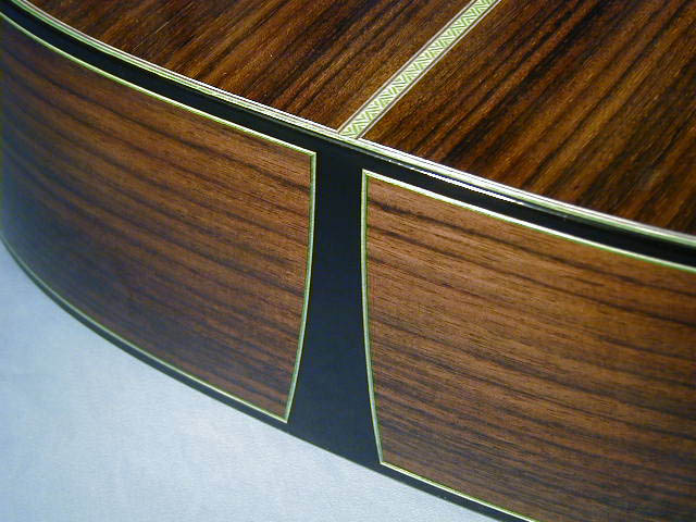

Anyway, since it's right behind me, here's one I did...

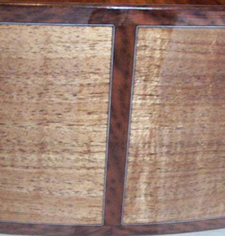

Here ya go Serge.
This is just a bit of scrap binding that I used for an end graft. The camera angle makes it look a little wedge shaped, but you get the idea. It's tiger myrtle on Tassy blackwood with a bit of shellac on the endgraft in case you were wondering.

Serge, I can't see from the photo how tight your joint is on the butt. If it looks good the way it is, you could just leave it. There's no rule that says you have to have a wedge or anything there. Some very nice guitars have been made without one.
If there is a gap there, I'd check and see if it's a uniform gap, and how wide it is. It might be just right to just glue in some purfling that would look good with your overall scheme.
Or you could even possibly fill it with wood dust from the wood your binding is made of (or some other wood that would look good there) and wick in CA glue. No one would know you didn't actually inlay a piece of purfling or that the whole thing wasn't intentional.
Even if the gap isn't even and clean-looking, it might be easier to carefully clean up the existing gap and fill it with one of my suggestions than to excavate a whole new area.

I was going to say what Todd said...I know a luthier who doesn't use end grafts at all, and it's beautiful. I chose to do one, but only because my sides missed meeting up by about 1/4 of an inch. And I used the box cutter, 1/4 chisel method, too.

I'd definitely agree with Paul use a steel straight edge and knife, then clean out with a chisel, your only trying to remove wood about 8mm wide and 2mm deep. I always do my wedges like that, just take it slow and you should have no problem.

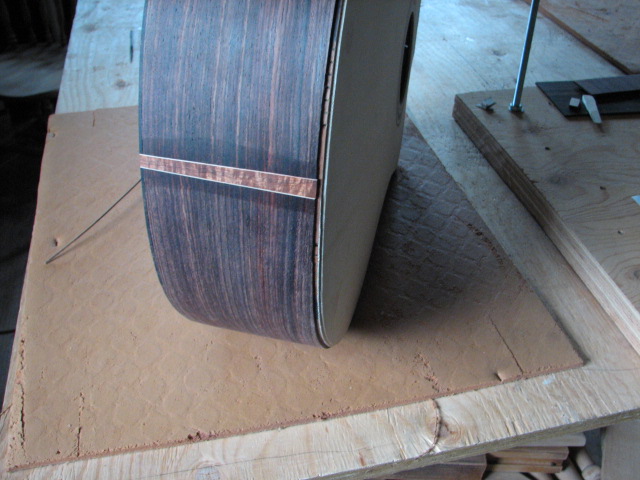

Here are a few of mine Serge...
Pretty realistic, huh?
PostPosted: Thu Jun 08, 2006 12:11 am
Okay, here's a real one....

Another vote for steel rule and box cutter. This happened to me once, and it was easy enough to fix. Even if you rout the thing you'll still be cleaning it up by hand to get square corners, and you'll probably spend more time fussing with the router setup to make sure that you don't accidentally cut into the binding then you'll spend just doing it by hand.
Since your box is indian you'll have no problem hiding any tiny glitches. A bit of melted shellac stick and you won't be able to see any flaws.

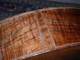

Thanks to some generous help from Dennis Scannell (True North). The jig, which is pretty typical is on his web page.

Serge, if the fit between the rib halves is good, you don't -need- a wedge in place at all.
