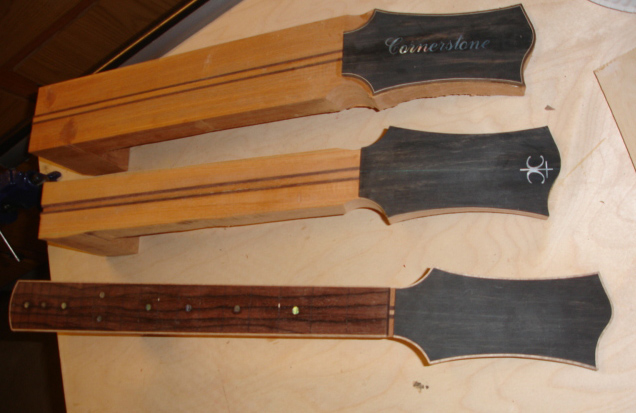

Its out of much frustration that I am posting this message....again!....I spent hours yesterday trying to bind the heastock with bloodwood but without success.
I took many of you guys' suggestions to bend the wood, I used a backing support, even boiled the strips. But they either snapped or got totally scorched without bending. I tryed settings between 300 to 350 degrees but all the same result.
Too bad I have already the fingerboard bound in bloodwood or I would just consider another wood.
The strips are around .055 to .060 thick, maybe I should thin them out a bit more or try veneer softener?
Help please

Peter,
I am trying to remeber, what shape is your headstock? Can you post a picture for us? I think that would help to see what your are up against. Sounds like it is plenty thin, but maybe a few thousands less would be the secret? I don't know, but there must be a way to make it work. Walk away for a bit, that always helps me.

Here's some headstocks....

Peter,
It might be easier doing 5 pieces with mitred joints - top, 2 sides and 2 bottom curves that meet the nut.
Or 3 pieces - 2 for the sides and one for the top.Dave White38879.247025463

If you are having that much trouble freehand on a pipe, then you need a form IMO. I bent two sets of bloodwood binding last week (.090), expecting some cracking after reading about the woes in here, but none showed up, and this is on a fairly tight waist and upper bout curve). Fox bender, spring steel slats, blanket at about 300 or so (I dont measure it, I just know its at a sweet spot - bends anything from EIrw to ebony at this setting). So, take a piece of baltic ply, or even MDF, build up abotu 3 inches of height and cut the shape you are after into it - now you have an inner and outer form to press into - use the spring steel and a blanket, a couple bar type clamps and go. I do floentine cutaway pieces this way, works beautifully (well the form is 6 inches high for these).

Tony....it might be a good idea to make a small mold for the headstock. I did bend the bindings on my bender for the body and it bent pretty well even with a very tight waist.
I do bend the headstock in 5 segments and then mitre then aglue them on the headstock.
