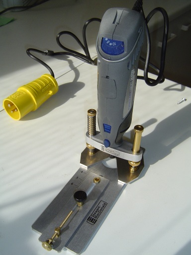

HI, I just purchase SM's router base and rosette cutter and am about to buy a dedicated rotary tool for it. I ahve a Dremel I use for other operations, but I reacall from a previous thread about Black & Decker being better for inlaying??? What is the best other than Foredom?
PostPosted: Tue Jun 20, 2006 8:47 am
personally if you looking for control and hp Foredom cant't be bet in my book but since you said other than foredom and I am assuming you looking for something to fit the SM base I think you are stuck with Dremel without doing some modifactions to the base. That being driven by the threaded port and room between the adjusting posts.

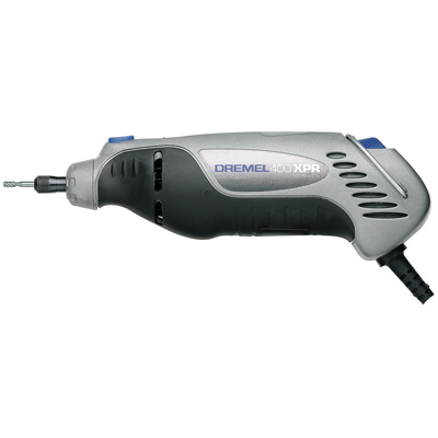

I really like the Dremel XPR 400. I make all my own custom rosettes, tiles, and rope, and the Dremel has been a great tool to work with. I also pair it with the SM base and it fits perfect. The bearings are great with no side movement at all.
Good luck!

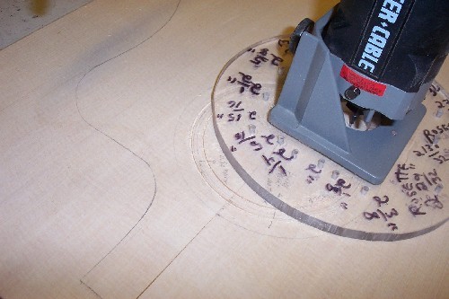

Here is one i made from Plexiglass after another attempt at copying the SM one crashed on the cement floor of my shop and after an original circle cutting jig was given to me by my friend Mike Tobey, his gift had the same fate. I just copied the jig that Mike gave me and it works great, you can make your own didtances from the bit by piercing 1/8" holes all around and having the same diameter pin on which the jig will rotate from.
You can do it out of wood also or buy it from Lee Valley for less than $30 IIRC.

I've got the new Dremel 400 and really like it, the bearing problem with the older 300 series seems to have been cured. Paired with the new SM circle cutting base it gets the job done just as it should with no fuss. I have some bad experience with B&D build quality, may or may not be typical, but they will fit the SM base.

I recently replaced my old Multi-Pro Dremel with the 400XRP. It has much better bearings than my old multi-Pro but I don't like the on-off switch at all. I could get a foot controler for it. I use my Foredom for rosettes and inlays because I have it located so that the flex shaft hangs above as I work and does not get in the way. I use my Dremel where I have to move work location. I also have a small die grinder and agree with John on the added power but there too the on-off is not convenient for inlay at least for me.
