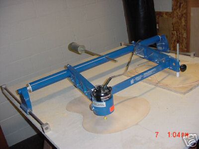

I have a Terrco duplicator and bought it for the express purpose of duplicating parts. I have used it for woodworking and guitar building.
At one time I wanted to build archtops but after two decided that I like playing archtops better than I like building archtops.
The cost of CNC has come down tremendously and is very attractive but still is an upfront investment that needs to be thought out carefully. I am not opposed to CNC woodworking machinery at all...for 15 years I imported and distributed across North America NC and CNC woodworking machinery. In the late 70's I sold the first 6 axis CNC Shoda router in the US.
I sold everything from automatic moulders to complete manufacturing lines for windows and doors. One window line that I sold to Anderson Window would make a double hung window unit from raw parts to shrink wrapped finished product in 38 seconds...To load everyone of the stations in that line took just under 15 minutes but after that it was 38 sec. per window!
I never intended to use my duplicator for small parts...today I use it mostly for rough carving out cello and Double Bass tops and backs for which it is a good fit.
I bought it instead of a CNC setup because I just didnt want to go to all of the effort to setup and program a CNC system. They are infinitely more flexible as to what they can do but for me I wanted a simple manual alternative that I could fold on its side (got the idea from Steve Anderson in GAL years ago) and push up against the wall.
For me I have no aversion to technology, it was actually a basic thing for me...I work as a software engineer for Microsoft's government group and when I come home to build guitars I did not want anything computerized as it is my way to kick back and do something physical, nothing negative about CNC, just what works for me.
Here is the setup I have...they were around before Duplicarver was around.
I bought my duplicator on eBay for $800.00 which was reasonable and have have gotten more than that much use out of it. There are alot of DIY plans for duplicators on MIMF and other forums if you want to go the low tech duplicator route... for me I had planned on going that route (given the fact I was looking for a manual setup) until one came up on eBay that was an attractive price in that it was less expensive than my lack of time.

Harbor Freight carries a duplicator in their catalog for around 200 dollars, at least they did last year. Now as for the quality of it, who knows.

I have done necks on my duplicator but not bridges. I build almost exclusively classical/flamenco so I have limited use of the duplicator for it but if I am building a cello, then the duplicator does the hard work. When I say I rough out necks...In the past I did more steel strings and used it for neck then. A classical neck is so set as to style, joints and material that it would be more trouble to setup for classical necks.
While some of the duplicator vendors sell them to make routed signs, for guitars I think that they are much better for roughing out parts and not fine work.
If you look at the Gemini duplicator you have linked above, one of its features is a handbrake! This is because with a duplicator the routing is matched by a corresponding stylus that guides off of a master...while you are focusing on keeping it on a portion of the master, the force of the router wants to pull the entire duplicator carriage in the direction of rotation so you are fighting against it. The handbrake helps in that it limits forward movement but the carriage will still want to pul across the work surface. It is not a hassle and is easy to control for roughing but for fine work, it would be a real challenge (read that as if at all!).
Any machine you add into the process of guitar building is there to replace or at least reduce the time it takes to do a machining function that would otherwise be done by hand. For building an archtop guitar or mandolin, for roughing out a large amounts of wood for a cello or double bass, a duplicator does great. Where a CNC setup really shines is in a few key areas...

Because I know and understand the limitations a duplicator has for me, I am okay with that. IF I were more actively building something other than classicals, and didnt have a duplicator, I would probably build a DIY duplicator and use it until I could afford/justify a CNC setup.
I only jumped into this CNC thread so that you could hear in perspective what a duplicator is good at, what it is not and how that compares with a CNC...all before you take the plunge either way
