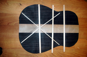

I am trying a dreadnought body shape, less waist and wide body, and also messing around with body depth. I will post my progress and show my bracing which is more similar to Dusina's bracing but includes an x.   Tomas38892.4446990741
