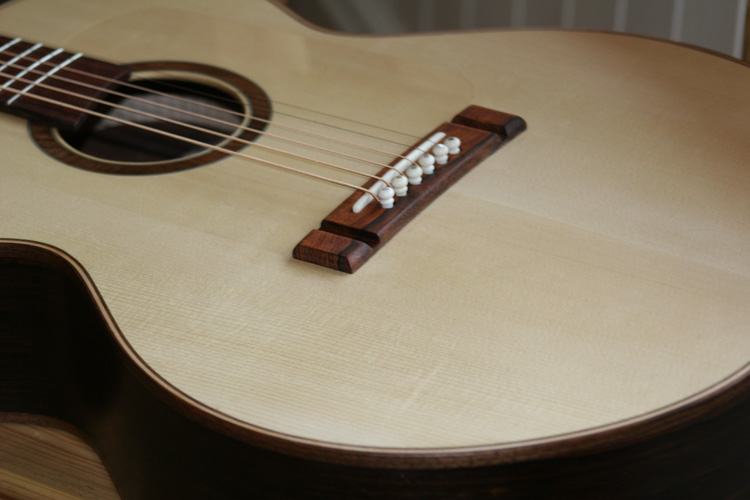

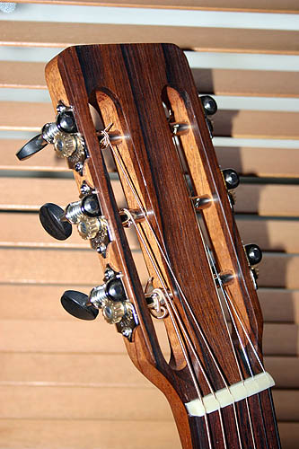

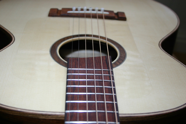

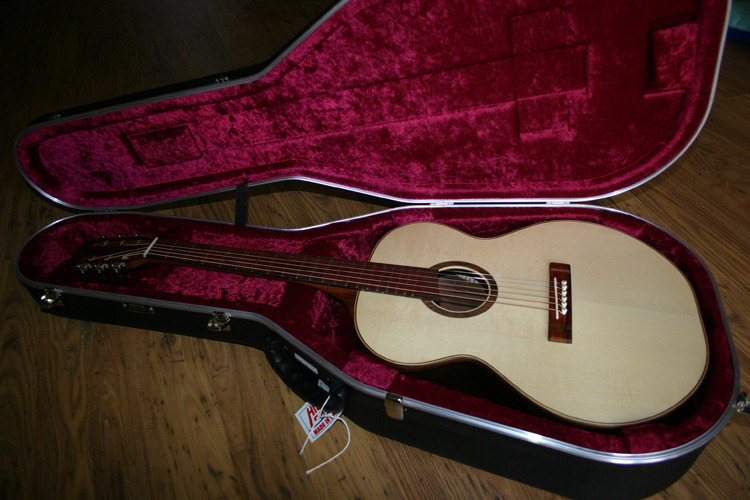

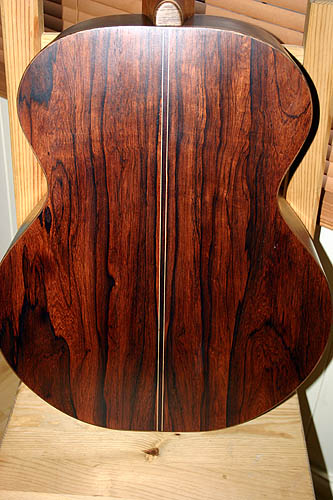

A few Pics of one that will leave tomorrow
It's a Mad Rose SJ.
Euro Top
24.9" Scale

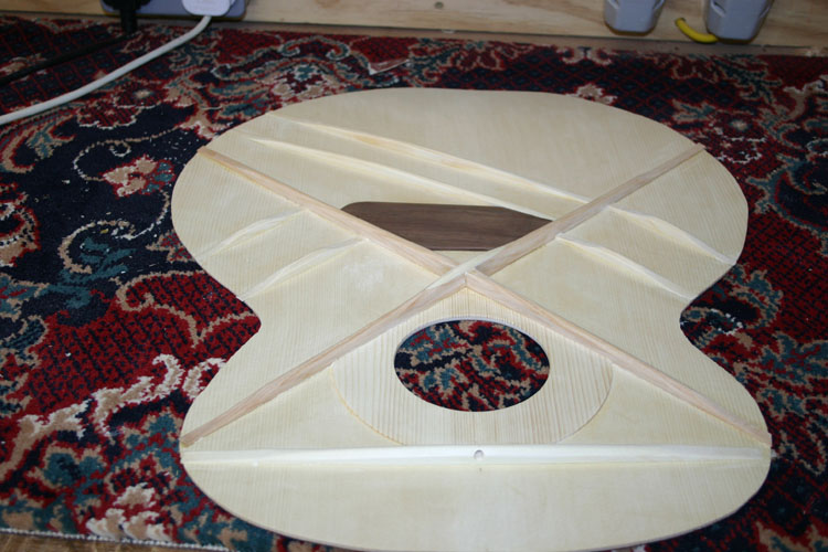

Oh I forgot to save this Picture I've been saving of the top bracing.

A real beauty Russell, That Euro top is outstanding! Cool bridge too! What do you use for your finish ?
PostPosted: Wed Jun 21, 2006 7:57 am
Hesh
It is indeed, I've used a Parabolic Arrangement on 4, 2 I have completed and 2 I'm just finishing up. This one is very responsive, I built it pretty light and even before the strings were on it vibrated along to the music in my workshop. What I've found so far with parabolic vs scalloped (at least the way I've executed them) is I gain speed of response with the Parabolic, but lose a bit of headroom. I'm getting the same nice balanced tone with both.

The Finish on this one is a Danish Oil.

   Gorgeous guitar Russel! I really like that Mad Rose... And that rosette is very nice as well. How is she bound? Is that walnut (rosette and binding)? I'm also very fond of the way the finger board protrudes over the soundhole... I just might have to stea... I mean, borrow that one from you...

Well Russell, you've done it again! Firmly up to the standard I've come to expect of you. I just love the clean elegance of your work and your subtle wood combinations, you really are right up there with the best of them now. I know it will sound great they always do.
You must be building up a very good happy customer base, the best advertising you can get.
Which of Madinter's Mad rose grades was that? I'm just about to thickness some of theirs.

The binding and Rosette are Walnut.

It is a Master Grade Set from Madinter, the one I'm french Polishing at the moment is one of their first grade ones, much plainer but beautiful in it's own way.
