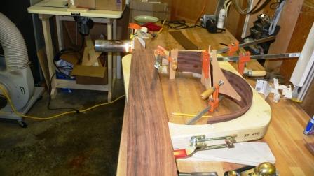

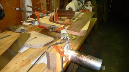

Starting my second guitar made of Madagascar Rosewood. Bending commenced today, thought I'd share some pics.
The bending iron is a piece of aluminum tubing with a 200W Halogen bulb and a dimmer switch.
The tough thing is keeping twists and flat spots out of the sides. I learned on my first that I could go back and "clean up" the little discrepancies after the main shape has been formed. There is a slight twist developing right where the tail block will reside.

Pete,
That is a great start. I like that bending iron, and it looks like it works just fine. What kind of top are you putting on it?

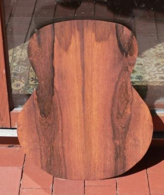

Pete, looks great so far!
How about a pic of the back that goes with those sides?
Mind if I ask where you got the MadRose?

Posts: 79
Dave - I bought the Mad Rose from Allied Lutherie, nice looking wood, much heavier than the Walnut I used for my first guitar; beautiful stuff
