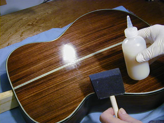

I used a spray gun at first but lately have done all with a brush.... It flows very well, no need to thin it out, its very forgiving and allows for any runs to be sanded away...
just gotta make sure to apply a VERY thin layer!

Get a foam brush from a local hardware store and get a VERY thin layer on the guitar....its nice to try and get a nice thick layer on it but then you'll have runs and clarity problems....if you see any runs you can wipe it away with your finger, don't worry....KTM-9 can be very forgiving and will level sand anyway.... 4-5 applications a day, 24 hour dry time, sand 400-600, rub with DA, apply again....and so on.

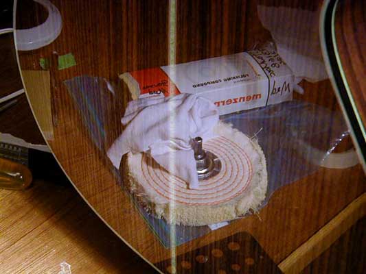

I let mine cure for 2 weeks (to be safe) and then level sand from 600 all the way to 1800 and then buff with Menzerna.

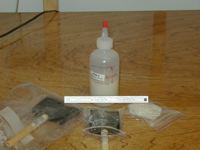

PostPosted: Mon Jun 26, 2006 4:07 am
Posts: 183
I've had no problem whatsoever using a foam brush with the KTM applied to the very tip only as shown in the photo below. The KTM-9 is used as is with no thinning. The key to avoiding bubbles is not only to avoid having a heavily saturated brush, but also by drawing the brush along the wood slowly. I've drawn the brush as slowly as about 1" per second. That said, I tried once to purposely to induce bubbles by drawing it across the length of the instrument in about 3 or 4 seconds ... and oddly, could not induce bubbles (contrary to my earlier experience). I'm not sure why so many people have trouble with bubbles.
Using this method, the finish goes on surprisingly thinly, almost as if it's squeegee'd on. Besides the obvious benefits, this has the side effect of not building up the large ridges you might get between adjacent strokes of the brush. Note that not much KTM-9 was used in six coats (see photo below). I believe the whole bottle is 8 oz.
While brushing requires more leveling than if spraying, it is easily done. And the results ain't bad either!
I've also tried padding it on, and this does yield good results as well. But, it takes forever! I did a test and found that with my relatively dry padding method, ten padding sessions led to a dry film thickness of only 1 mil! No wonder it took me 30-40 coats on a wood sample I tried.
