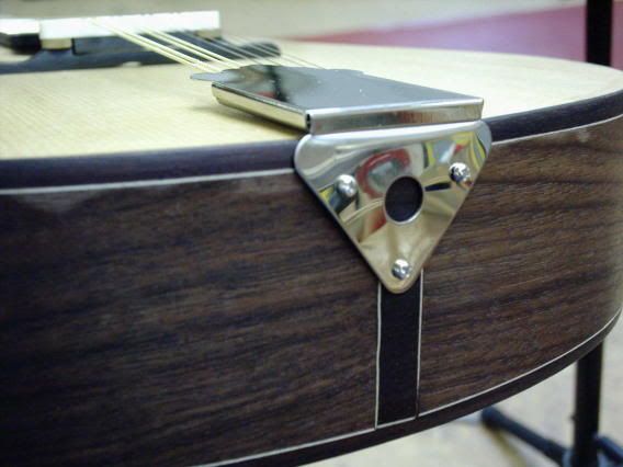

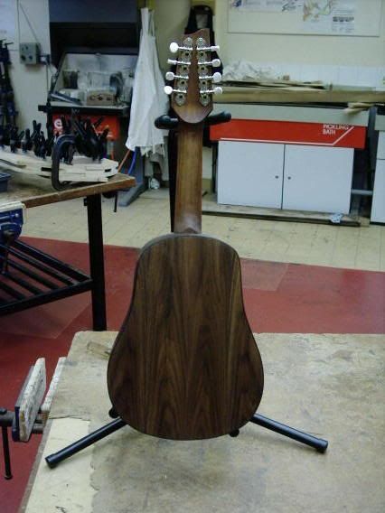

Hi gang, here's my Mandonaught, completed today.
The top is half a AA sitka classical top from SM
Back & sides are walnut salvaged from a shopfitters bin... (honest!!!)
the neck is (I think) Iroko form the same shopfitter.
Bone nut & bridge from inlaidartist on Ebay,
Rosewood fingerboard, Rosewood binding, Maple purfling, tuners, Tailpiece & truss rod all from SM
rosette is a strip of mahogany I lifted off the floor......
the sides & binding were bent using a steam wallpaper stripper which worked really well!!!!
Good bits are the walnut and the binding, I'm REALLY pleased with this.
Bad bits?
Well the 12th fret inlay is off centre, and the Truss rod cover isn't the straightest.
Sound is really mellow already (bear in mind the strings went on about 6 hours ago!!) It's more like a guitar with a 10th fret capo than a mando. it's not as trebley and theres FAAAAR more sustain than any mando I've ever played.
All you guitarists, it's like strumming at the 12th fret rather than 1cm from the bridge if that makes sense.....
I'm REALLY pleased with this one.
