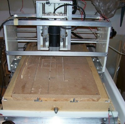

      I've built 2 at this point. As I've mentioned in a couple of threads, John Kleinbauer has some nice plans at around 35 dollars. He is at crankorgan.com. I first made one from his plans and then moved on to a machine of my own design that was large enough to rout bodies and necks. I purchased a motor/controller system to avoid problems in that area. You can probably get a machine up and running for 300 dollars or so.
     There is a lot of freeware/shareware out there, but I've never had good results with them.
hobbycnc.com sells kits of motors and controllers and may wire them for you too.
     I have an old version of Bobcad to convert DXF ( autocad) files to Gcode ( cnc language). That works great. I am constantly amazed at what even home brew CNC is capable of doing.

Here is a picture of it.
