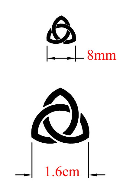

The next are the "trinity" fret markers. I think I will cut out the entire outline and remove all the inside material, than fill with epoxy again, maybe not though.
What do you all think?

The third - trinity fret markers -- I dunno as the larger one (1.6 cm) is pretty big and that's a lot of ebony dust to CA in. Are you getting these from Andy DePaule? If so, you might want to ask what he would suggest.Anthony Z38902.1072916667
PostPosted: Tue Jul 04, 2006 1:51 am
Yes, Andy is making all of the parts for me. I will send him an email.
