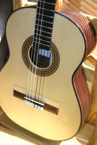

Great story and guitar. I'm sure it was a very rewarding experience for everyone involved. I do have a question though. What is the lite colored piece in front of the bridge and what is its purpose?

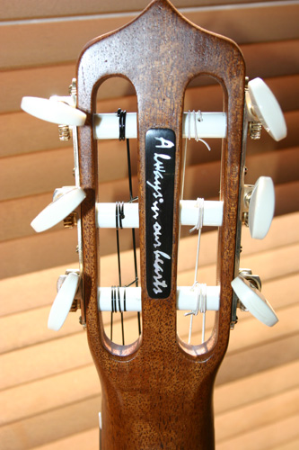

I like the "Always in our hearts".
Was that your own idea, or one of the family's?

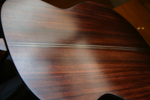

Russell, I think the back of this guitar is one of the most beautiful ever. Congratulations on such a fine piece of workmanship. Okay, I'm saving these pics in case I ever do a classical. Great story to this one, thanks for sharing it with us.

The customer had the wood to make this guitar from for 30 year, and the top is a beautiful piece of German Spruce, but there was a small crack in the top which I closed with glue, but during final sanding it kept roughing up an I realised it went nearly all the way through, I discussed changing the top, but my customer wanted me to use the original, so I put the spruce patch along the front of the bridge to give it some reinforcement as I was worried it might open up in the future.

The always in our hearts was a request from the family, the reason it's on a little plaque is, John didn't know about it so I made it removable just in case, it also has his signature inlaid into the headstock.
