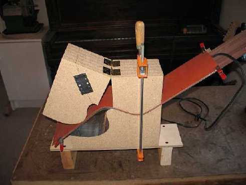

I've only done one cutaway (my Weird Classical), which was
not quite as sharp as this one is; therefore, even with the
easier-to-bend rosewood, I'm still a bit nervous about it. So
what I did today was build this jig I saw somewhere here on the
forum. I've already bent the waist (by hand), and am using a
shorter (uke) heating blanket I had on hand.

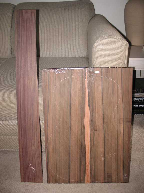

I'm attaching a photo of the jig, and also what my Malaysian
blackwood back (not jointed yet) looks like:
Again, thanks for all the help and encouragement!!!kmatsu38893.9343055556

Here (I hope) are the two photos of my cutaway bending jig (I'm not actually
bending yet -- it's just to show how it all goes together) and my
Malaysian blackwood back (not yet jointed):

PostPosted: Sun Jun 25, 2006 1:48 pm
Hi Kathy. One little "trick" I picked up while in the Somogyi class was to laminate the sides, on some of these tougher woods if you bend them down to about .04 and laminate them together with epoxy. From what I picked up from Ervin the sides are simply the "rim" that the vibrating plates attach too. Without going into too many specifics he wants the rim to be as absolutely solid as he can get it.
With this being said, I wonder if you could call Todd and get a set of Malaysian blackwood sides that are too thin to be used on a set.
Pretty wood BTW. Good luck.

Once again, thanks to all for your ideas!
I think I'm going to still go for the Indian rosewood for the sides -- I'm
attaching a photo of the two together -- it looks pretty close to me. The
only difference would be that the rosewood doesn't have that really wide
striping and is a little more pinkish. At any rate, I'm going to bend the
rosewood sides and see then how it looks up against the blackwood; it
couldn't hurt to try it!
