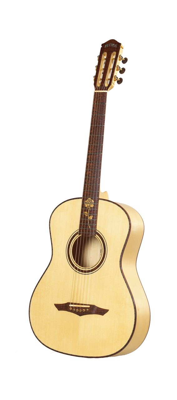

But gander at this picture of a Bruce Petros Yellow Cedar guitar. It looks, certainly, worth trying.
Everything is Yellow Cedar. Well, the top, back, sides and neck are.
Here's another shot:
I really love this guitar. You can almost smell it from here, can't you? I think you should try the Yellow Cedar and report back.

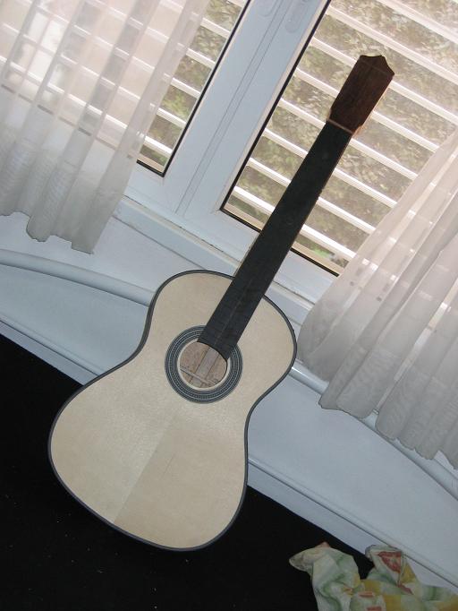

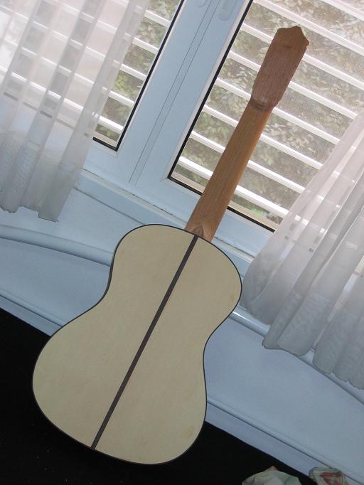

i m currently building a flameco guitar using yellow cedar for B/S.
the wood bent easily.
one thing ill pay attention to is not to scorch it.
here are some pics:
Udi.

Udi - no fair, you stole my trim scheme in advance! I'll watch out for scorching. Basically same deal as maple?

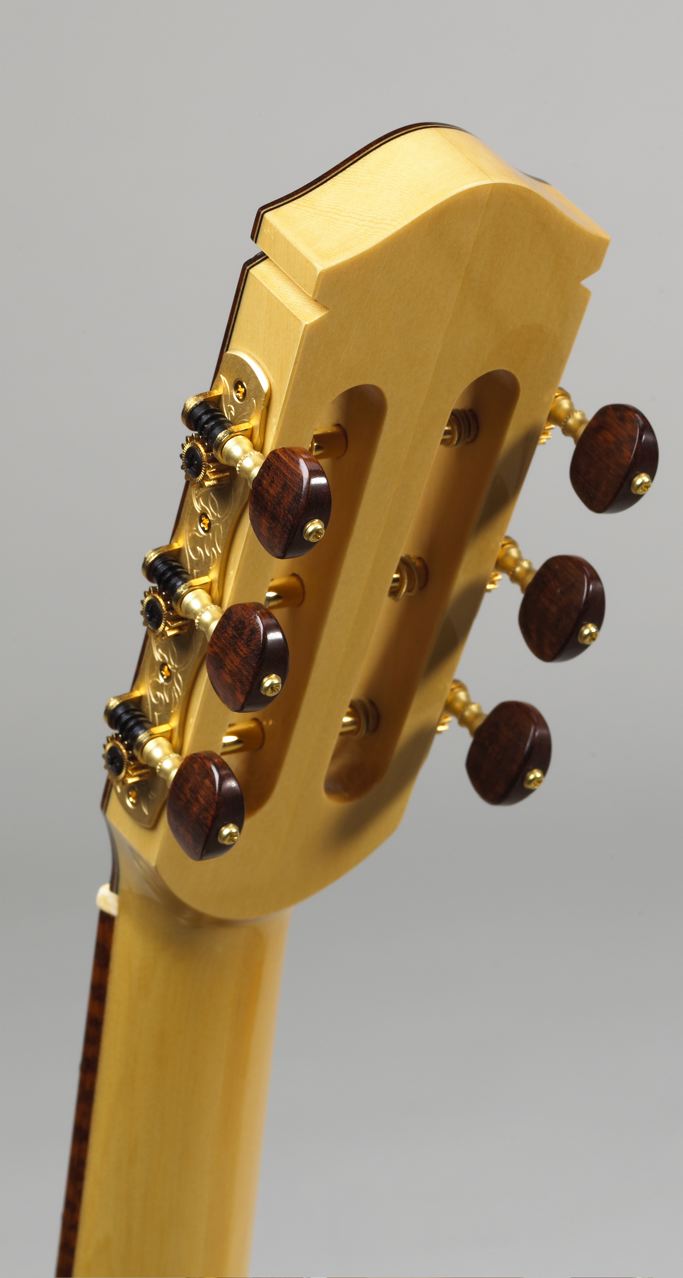

I build more flamenco these days with tuners as that is what alot of players are looking for but love the look of pegs.
I have turned my own pegs but have switched in the last year to a new type of pegs that is really nice. Check out http://www.pegheds.com. It is a peg for violin family and flamenco that has an internal 4:1 gear that gives the tuning control of a tuner with the look of a peg. The hole is tapered with a reamer the same as other pegs. David Schramm and a few other builders are starting to use them for their flamencos as is holds pitch better than straight pegs.

the binding scheme is pretty staright forward - dark madagascar rosewood(to go along with the mad.rosewood bridge and heaplate). and three layers of B/W/B purflings around the top.
the guitar looked a bit too bright to me and i had to break the white-ness in some way.
as for the yellow cedar, not only does it scroch easily it is also pretty soft, so take care when sanding the sides and when cutting binding ledges.
