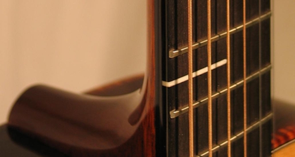

Serge, I use the plastic rods which are very easy.
here's one I just did:
