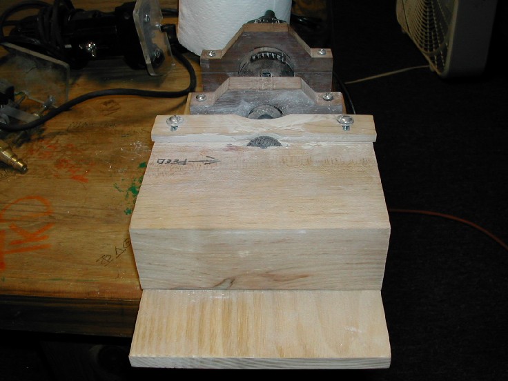

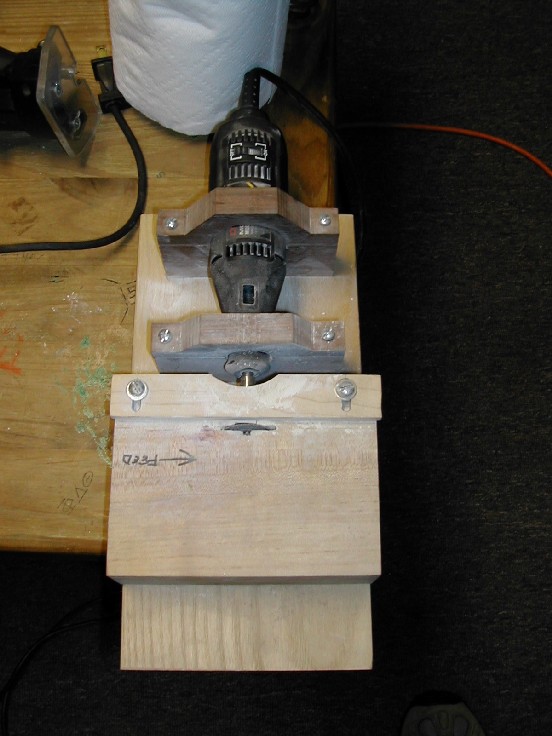

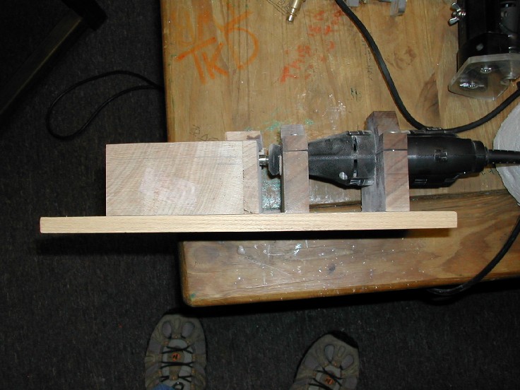

HERE is my jig.

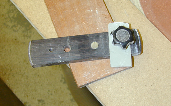

jsut took the pic this morning - here it is. Notice I have used both ends, one gives the std 5 inch radius to the inner curve of the shell, the other is 4 inch. Using a circle cutter jig I routed the ledge that the shell sits in - about 40 thou deep to hold 50 thou thick shell. The wood is afr blkwood, so it holds a thread well, the clamp bar is a pc of aluminum with a couple small pieces of veneer CAd on at each end - they allow the alum to sit just above the blkwood, and give the screw some ability to apply pressure on the shell piece. SImply clamp up to the sanding disc, set for whatever width of shell you are after and pivot/sand away.
