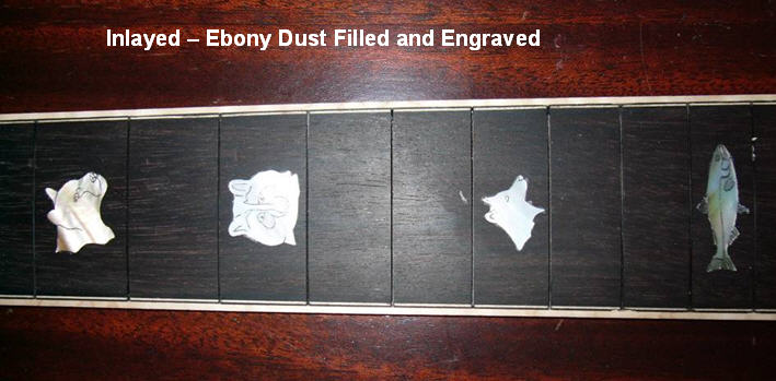

I inlaid the ebony headplate on a steel-string and used ebony dust mixed with CA as the filler. It blended in perfectly. A lot cheaper than the black CA, that's for sure.

Rod - India Ink, Staedler .005" tip black drafting pen for fine lines and Grit Laskin filler. All work just fine!
If the graving is done on the fingerboard you can seal the filler with thin CA.
These were filled with India Ink brushed on with a very fine tip artists brush.
Anthony Z38901.9095949074
