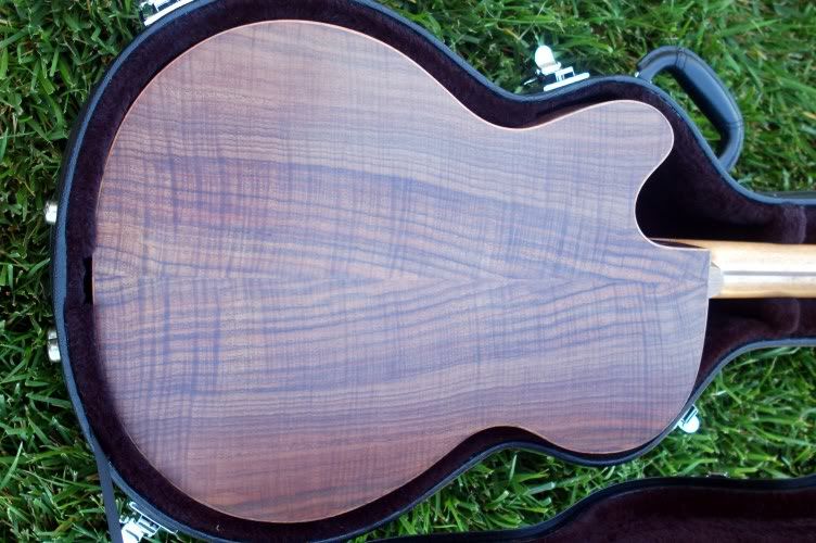

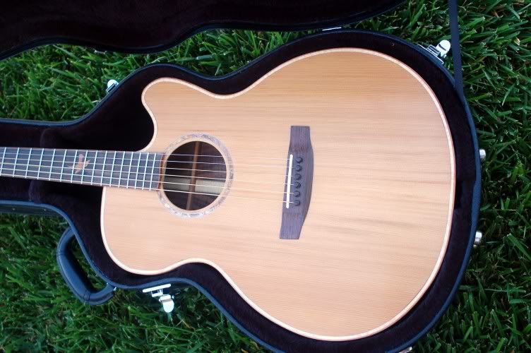

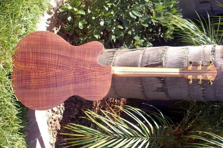

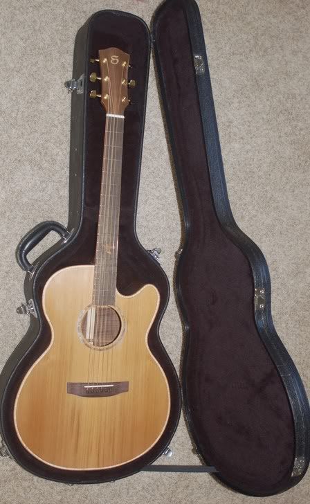

It is finished! I will be shipping this one out on Monday.
This is the first one that I built specifically for someone outside of my family.
It was the forth guitar I started, but the third one I finished.
It was so fun to work with someone and design a custom guitar.
The process of choosing woods and dimensions and custom inlays etc. is a thrill.
This was the most difficult guitar for me yet.
The Venetian cutaway was my first and I made the radius to tight.
It made bending the binding and purfling a real chore.
I like this guitar a lot and I'm going to miss it.
It is a strange feeling seeing the first one go.
I learned so much building this guitar.
I am very excited to start on my next one.
This guitar is in no way perfect.
There are several flaws that you can see in the pictures.
I think it plays nice and sounds good.
We'll see if the new owner agrees and decides to keep it.
Here are a few shots of the finished product.

PostPosted: Sat Jul 08, 2006 6:03 pm
Steve, that is sooooooooooo nice. Wow, I don't think my 4th turned out that nice.
Is that Acacia? Very nice zoot. Looks good to me, I can't see anything wrong with it.
What's the finish? Nice work with the spalted maple too. I realy like it.

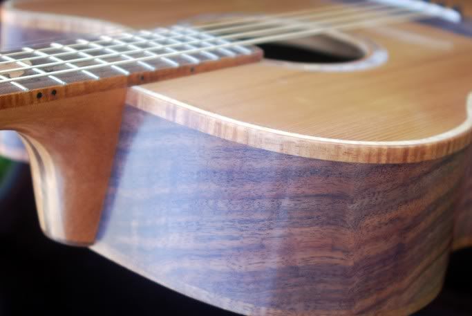

The finish is a water-based satin. The customer realy wanted satin. I wasn't too excited about it. But I must say that I really like it.

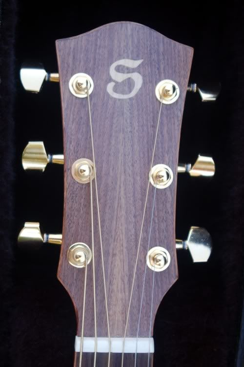

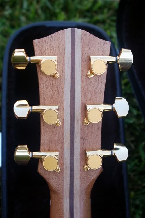

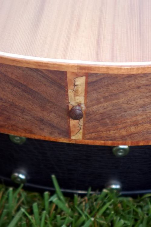

The back and sides are figured black walnut, the top is cedar. The bindings are koa and the purfling is maple. The rosette, bottom wedge, and dove are spalted maple. The neck is 5 piece laminate with mahogany, maple and walnut. The "S" is maple.

Steve, very nice work, you can be proud of what you have achieved, especially if it was your first commission, the stress involved with it and also your first cutaway which is really great looking and audacious for the tight curve! I see that you have a 5 piece neck like mine, yours looks really nice!

Great guitar you should be really proud of your work. I really like the finish, it allows the wood to just do it's thing and still look like wood. The wood combinations are inspired the fact that they all come from the same colour palette shows great taste. The walnut should let the warmth of the cedar come through so the sound should be great. Wonderful work your customer should be really pleased.

[QUOTE=vpelleri] How does the walnut sound?[/QUOTE] This guitar sounds nice. The fundamental is clean and strong with good sustain. This guitar does not developing the lush overtones that it would if it were rosewood. It has nice bass, I think due to the cedar top. It is nicely balanced, not very loud but it is a 000 size.

That's a really pretty guitar. I love the end graft. Nice choice to use the spalted maple for that and the rosette. Very nice. Can't wait to see your next one!
