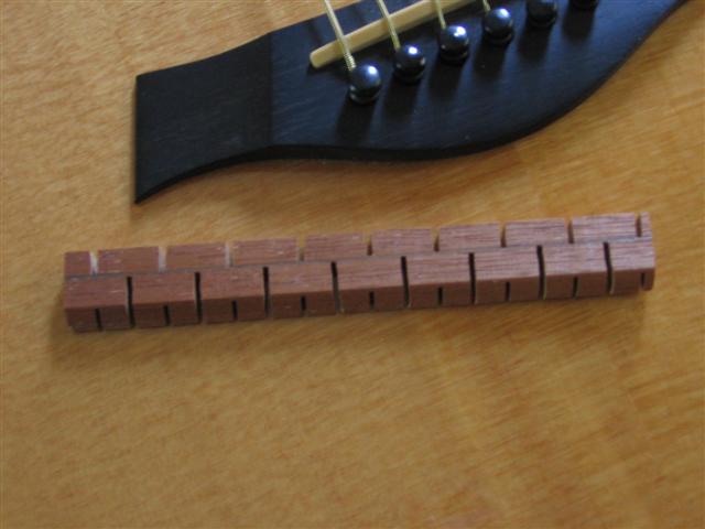

Well, during a recent vacation, riding a tour bus, I spy some dentil work on a vintage building. You know the kind, just looks like little blocks glued and spaced along a board, real nice look on an old building.
But, this was different... These dentils didn't go all the way through. They alternated with cuts from the top, then from the bottom, kinda neat, but different to the norm. Still had a similar effect.
Immediately, I called for a pen and paper and jotted the form down because I could see a solution to a guitar-related problem. Guitar dentils that don't flex, errrr, we call them kerfed linings.
Below, you see the modified reverse-kerf linings many of us use. I took a section and cut it to match the dentils I saw on the buildings. Cha-ching, the linings now easily flex in two directions, eliminating the problem of installing them on domed tops and backs.
Okay, this is a freebie for all my luthier friends. Just one thing, if you use it, simply refer to them as Dickey Bi-Flex Linings 2006. Try it on an old piece of lining laying around your shop. Yes, they will be slightly more delicate, but the force to install them will be minimal, because they are flexible.
This applies to triangular linings too, and I think that a double alternating cut to them as well will make them ultra-flexible.
Here is a pic of a reverse kerf lining with the Bi-Flex cuts added. I didn't try to be greatly accurate, just wanted to make sure it worked before sharing it. I got about 3/16 inch flexed curve in five inches without breaking.

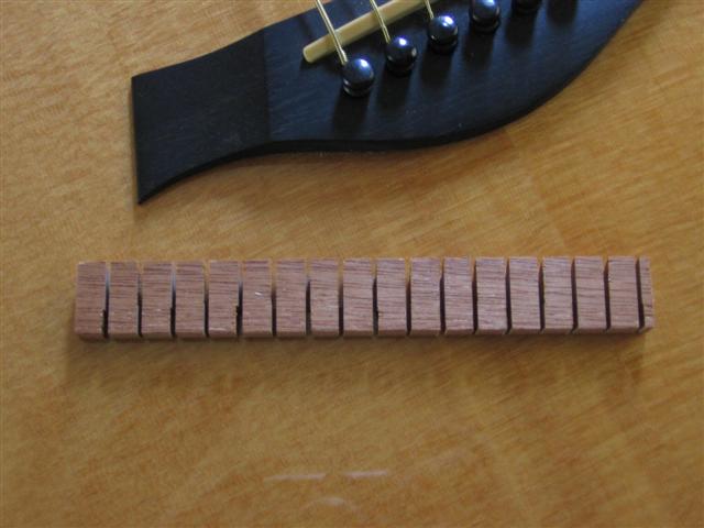

I'm not sure, though, if I'm properly grasping how you're doing this. Maybe some "before and after" photos would help (with pictures of both sides of the linings). Thanks.

Okay. Start with a piece of standard or reverse kerf lining. We have no problem going around the curves because we've kerfed the lining, right?
Think of it this way, since the advent of the domed top and back, we have to bend in a third direction. So we have X, Y, and with the added half-cuts we can flex in Z direction, or the dome of the back, where we have the difficulty.
All you do is add a line down the center of the lining on the uncut side. Cutting in half way from the edge along the existing slots, gives you what you see in the upper photo. The lower photo reveals the back or glue side, no visual change, it's already cut there anyway.
Notice the inaccurate cuts done on my bandsaw from the frontside so I could see the line. Cut every other slot, halfway, flip the piece and cut every other slot from the other direction. IF you didn't stagger it, it would simply cut it in two, oops.
Try it, and you'll be amazed how flexible your linings will become. Simple change, big difference in the ease of lining installation.

[QUOTE=Dickey]   Cutting in half way from the edge along the existing slots...[/QUOTE]
Sorry, Bruce. Does this mean to cut halfway between the existing kerfs, parallel to them?

[QUOTE=CarltonM] [QUOTE=Dickey]   Cutting in half way from the edge along the existing slots...[/QUOTE]
Sorry, Bruce. Does this mean to cut halfway between the existing kerfs, parallel to them? [/QUOTE]
Carlton,
No, you recut the existing kerfs through. The first one cut from the top and stop and the midpoint, the second one cut from the bottom and stop at the mid point then repeat. Like this.
The first picture in Bruce's post shows the end result from the back side (or front side since it's reversed kerfing)Scott Thompson38909.8285648148

Scott, exactly, that was the view from the tour bus window. IT clicked in my pea brain that it would work to free up the kerfed linings in the third dimension. Good work there with all the little red arrows. How'd you do that? Grin.

Thanks, Scott. I get it now--alternating cuts!
Ron, The benefit here will be the ability to bend the lining up-and-down as well as forward-and-backward. Building with a high dome (or a low one, for that matter) requires making the lining conform to the irregular contour of the edge of the sides. Since regular linings can only be bent to fit the outline, and not the profile, of the sides, you could end up with short or uneven-looking linings. Looks like this might solve that problem. As for stiffness, well, as you know, everything in guitarmaking involves compromise of some sort. If you want to benefit from one change, you might have to find another way to compensate for it elsewhere. This new kerfing method may or may not cause a problem with stiffness. We'll just have to try it and see! Pretty cool idea, in any case!
