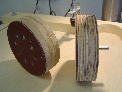

If you are concerned with it but like its approach to thinning material you can use the sanding disk tool of similar design that was first built by John Gilbert. The operation is identical to that of the Wagner with the difference being that the "cutting" replaced by an abrasive sanding action from a plexi sanding disk mounted on a 1/2" steel shaft that is mounted into a drill press. LMII sells a version of it (John Gilbert's original disk was a disk made from 1/2" aluminum bar stock.
It is just over 4 1/2 inches in diameter so a 5" adhesive backed disk does a good job (4 1/2 will work also).Shawn38912.9347222222

[QUOTE=Shawn] John Gilbert's original disk was a disk made from 1/2" aluminum bar stock.
It is just over 4 1/2 inches in diameter so a 5" adhesive backed disk does a good job (4 1/2 will work also).[/QUOTE]
Just so folks know, you can buy the aluminum disks directly from John Gilbert. I picked up a couple from him in the last year, and it was a pleasure dealing with him. They are not listed on his web site so you need to contact him about purchasing them.
We had a thread on this a while ago, so try a search in the forum archives. The can be used for much much more than just thickness sanding (eg. add leather to the top and you can keep that chisel stropped in short order).

Or just make your own in ten minutes.
