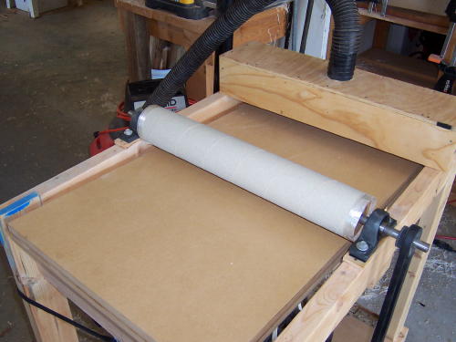

I'm also a newb at building guitars and working on no 2 right now and you'll be able to discard what i have to say in a second but let me just say this, one of the first jigs i made to help me pronto and save a few bucks was my 18" drum sander, you have a lot of info on the net to help you build one, you can either have a free plan or buy one, i think the name that comes to mind for the free plan is Dominic P, you might want to copy and paste this link in your browser! Check it out!
http://www.rockslide.org/drum%20sander.html
Here's apic of mine after gathering some ideas out there
It does a great job and i'm proud it only cost me about $200 in parts!

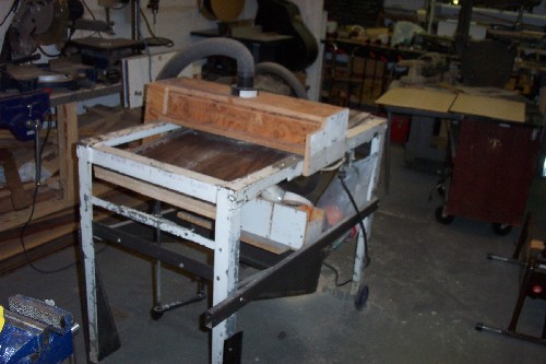

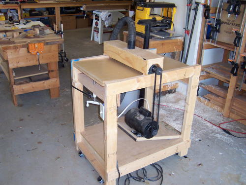

I'm using my home made sander too. It is 20" wide (sanding surface). It works great!!!   I've done all the thicknessing for three dreds and haven't had to change the paper yet. Of course, I'm doing cherry which isn't oily, so I haven't had to clear a single clog. I do make many passes, but it really works well. I have 100 grit velcro backed paper on it, made in Canada, I think.   Also, the dust collection with just a shop vac works very well with it.
PostPosted: Sat Jul 15, 2006 2:52 pm
Ron, what size motor you have on yours please?
PostPosted: Sat Jul 15, 2006 3:35 pm
I can look tomorrow, but I think it is 1 1/2 hp.
PostPosted: Sat Jul 15, 2006 7:02 pm
Thanks Ron, mine being 1/2 hp is probably under powered, i'll upgrade when i put my hands on a bigger one!
