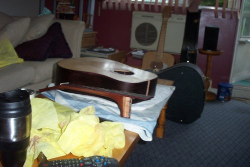

Hi guys, i have applied 3 coats of FP on my top and i have some spots that are not as shiny as others, it looks uneven or should i say blotchy in different spots?
What should i do with this please? Resand down to bare wood?

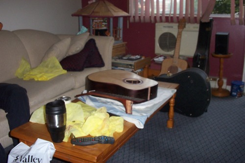

Hey guys, here are a couple of pics that show what the top looks like,
what are your thoughts?

My best (inexperienced) guess would be that you are using too much oil.

I second what Rod says - I have this printed out and refer to it for technique, although I don't do the whole pumice fill thing. You only need a minimal amount of oil - like 1 drop, and then only if the pad is dragging, add shellac when you stop seeing the little comet trail that forms when things are going just right - 5 to 6 drops. Moderate pressure first, and continue with firmmer pressure as the shellac dispenses...
I think it will be fine Serge - I know when I have done FP on raw wood, the top took longer to build up than the sides and back. Perhaps the spots that look blotchy are a little rougher than the rest of the top...

From what I can see, it's probably like Mark said. Maybe those spots are a little 'rougher' than the rest. What are you using for oil?
I guess you can always try a few more sessions and if it doesn't get better you can always sand it down and try again. That's the beauty of FP.

I'm still working on perfecting my fp technique, but I thought I'd pass along my experiences with this. I find that it is pretty common to have rough or uneven spots when I first begin fp'ing. I just continue to apply the shellac until I know I've built up a halfway decent amount of it. In this early stage of the process, I don't use any oil.
Then I sand back lightly to smooth the finish with 320 grit and a firm foam pad, cleaning the paper often as it gets loaded up. I don't sand back down to bare wood.
In my experience, the rough spots are caused by the grain being raised somewhat. Nice thing about the shellac is it fixes the grain in the raised position, so a light sanding gets rid of it. If you sand all the way back down to bare wood, you might end up raising the grain again with you next fp session.
I have also had situations where the color becomes sort of uneven on the top with the first applications, almost blotchy looking. The unevenness begins to disappear with further applications of shellac.

It appears to me from the little info you have given thus far and the picture that you need to build more. Three coats is not much build especially if you are using the method I show in my finishing DVD. Keep building and do not add oil and begin the polishing stage until you have enough build to do so.
